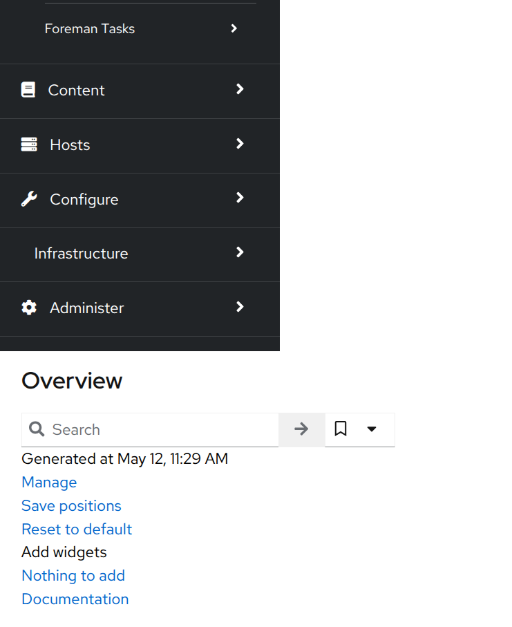

Problem: Browser display is formatted oddly, all detail is shown below the menu bar and not formatted as tables

I’m starting to tear my hair out. After my last upgrade go-round a month ago, my browser displays have all been very different, the detailed data is not formatted in the browser like I’m used to. I’ve gone so far as to completely reload the OS, load fresh copies of Katello and The Foreman packages, retaining the database, pulp content, and contents of /etc/foreman. Okay, a couple of other things. I see a lot of errors in production.log. Earliest is:

Another interesting observation is that your screenshot is using the Satellite color scheme instead of the upstream Foreman one. Would you mind sharing any errors the Javascript console shows?
This might just be a coincidence unless the foreman_theme_satellite gem is installed, I’ve seen my dev environment UI break in a similar manner before where the UI turned black. It was temporary though, and fixed itself on a reload.
