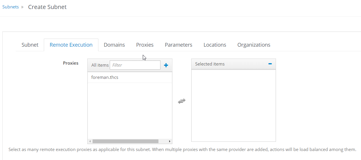

Each host is part of a subnet, each subnet in turn has a configuration tab for setting which “remote execution proxy” to use:
By default, if the host is unreachable via tha “remote execution proxy”, it will look for a different remote execution proxy to use, within the location and organization of that host. You can change this behaviour in the global settings:
In your case, you could try and disable “Global Proxy” and see if you get a better error message. (Could be that either your dynflow service isn’t running or isn’t correctly configured, …)
