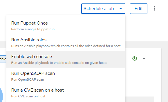

Did you try enable web console first?
click on arrow and enable web console on host first
