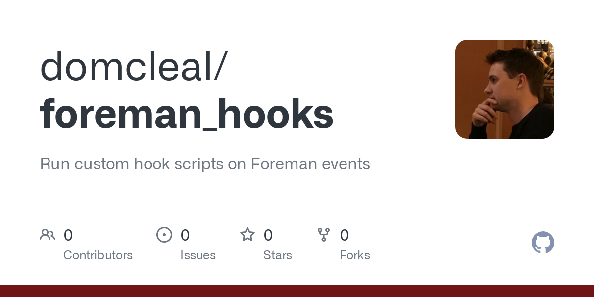

I wrote a plugin recently called foreman_hooks that might solve this for
you. It's a generic plugin that can then call all scripts in a
directory based on any event in Foreman, so you can then easily add
multiple scripts for different tasks.
You're right though, if you're writing it as actual plugins, there will
be a small duplication in extending or observing a particular class, but
it should be relatively small. The bulk of the work I think is in
having separate projects, gems etc for each individual hook, so having
one plugin for this would help.
Anyway, foreman_hooks is here:
It runs hooks both on model events in Rails (e.g. after_save,
before_destroy) plus can extend the host orchestration framework in
Foreman, which is probably the most useful feature.
You'd create a script such as:
~foreman/config/hooks/host/create/50_register_system.sh
Then the script gets called with two parameters. The first is either
"create", "update" or "destroy", which you should use to handle your
event (note that Foreman orchestration will roll back if there's a
subsequent failure, so you might get a "create" followed by "destroy").
The second is the name of the object, e.g. the hostname.
A task for tomorrow is to write this up in a blog post with an example,
maybe a small screencast too. I'd be interested in your feedback!
