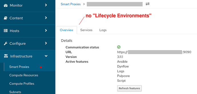

Furthermore, according to step 3.5, “Lifecycle Envirments” should be configured in the Smart Proxy. But this tab is missing:
MQTT Push Provider should be configurable according to documentation without errors.
