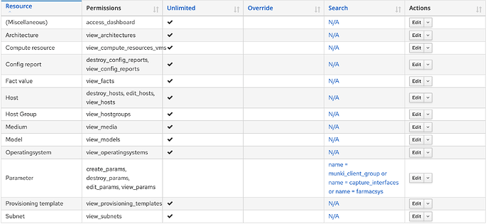

Trying to create a custom operator role that currently has these filters set:
but when a user with that role tries to modify a parameter they are allowed to change, they get this on submit:
We’ve added the view_operating systems filter but no change. What right is missing that makes the operating system be blank ? For an admin user, the operatingsystem is filled in.
These systems are all Puppet managed hosts.

The problem is that the role can’t even pick an OS - the list is blank. An admin role works without issues so it seems all of the required information is there but the custom role can’t see it for some reason.
I’ve also tried cranking up the debug log level to see if there is an error or some more detail on why but nothing useful seems to be logged.

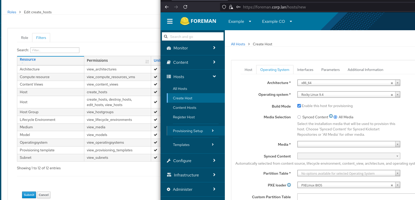

Just started playing with this my self this is what i did.
and it allows the user to select to os.
You need to add >Content Views>view_content_views

@dsexton18 Your post did help me after all - I built a new Role out using yours as a guide - attached is a screenshot of what worked for me. Thanks for the help!
