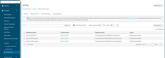

An update on this:
If I enable the Repository Sets on the Activation Key that I’m using for the host BEFORE the registration of the host:
At registration, it shows the errata message, but if I clear it, and upgrade a package on the host, the errata message is not there anymore, :slight_smile:
