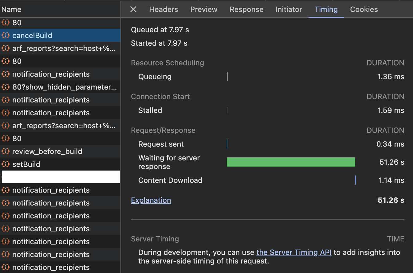

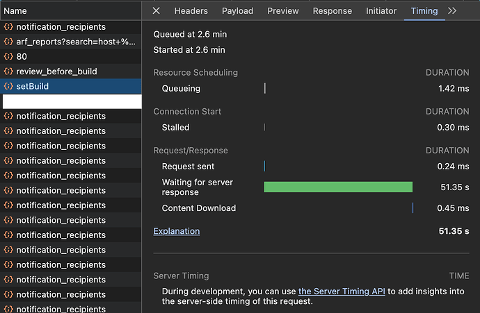

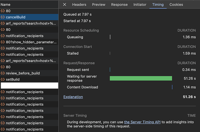

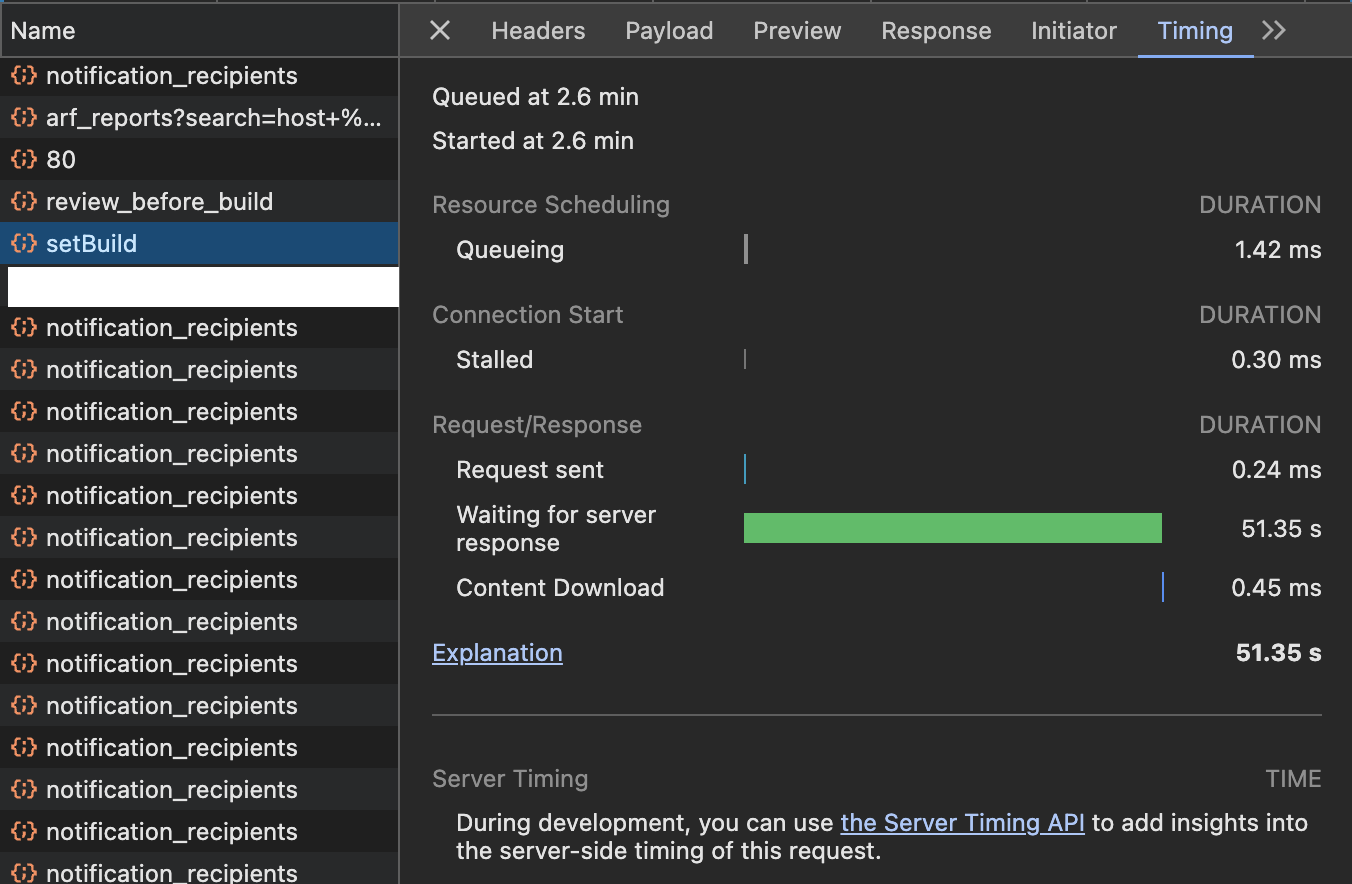

I have noticed quite a bit of delay when clicking Build and Cancel Build on a host, this delay is roughly around 50s of starting the request, I can’t see too much inside of the logs and have turned on Debug Logging on the Foreman server. I’m after some better ways to debug this issue, or if anybody else has experienced it, what they did to fix it.

Attached are some images of the request

No longer need the help, user error (me)!
In our case Foreman was trying to resolve the DNS name of the host that was getting rebuilt, against the SOA/NS, which was problematic in our environment. Switched the setting “Query local nameservers” to a Yes and problem resolved.
