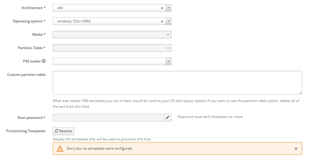

The only errors I really see are related to a 500 error when attempting to retrieve templates for the host - remember, this was created through a callback from ansible:
