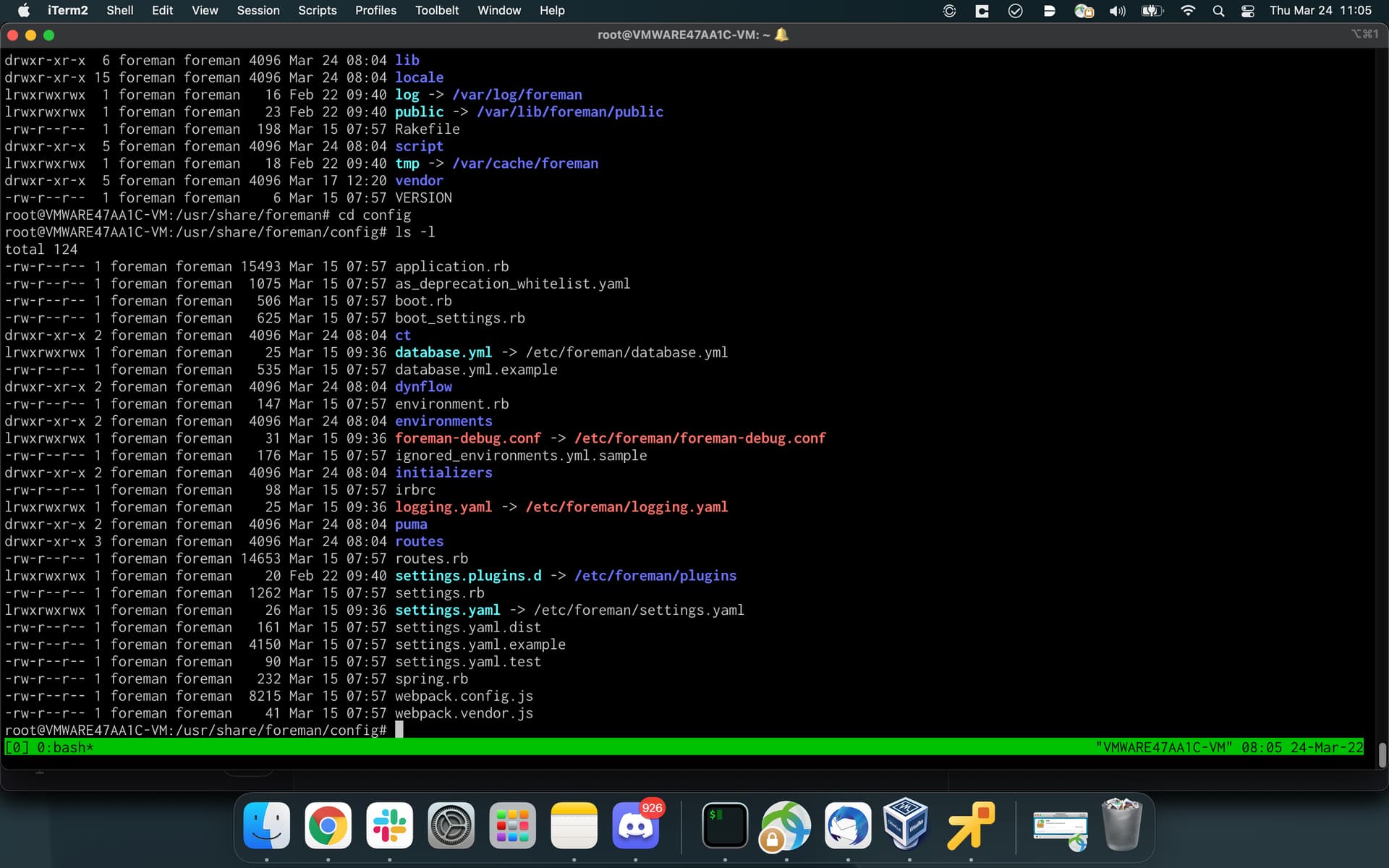

I’ve done some more testing and it appears that the rake db:migrate task is failing due to a missing configuration file. There are two broken symlinks under /usr/share/foreman as shown in the attached screenshot.
Reinstalling the foreman package did not change anything.
