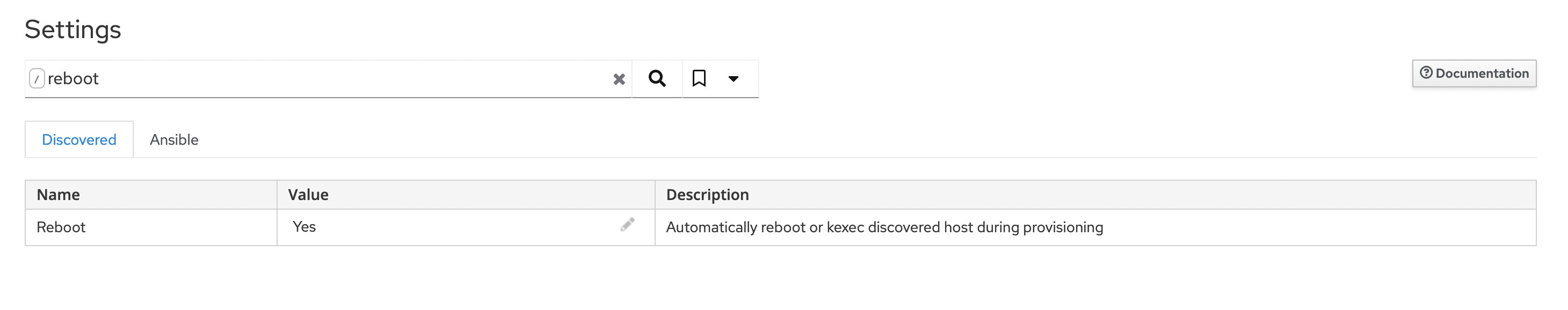

I have Settings>Discovered>Reboot = true

Here is the description of that setting:
Automatically reboot or kexec discovered host during provisioning
Am I misunderstanding the way that the automatic reboot works?

Here is the configuration setting for reboot of discovered hosts:

Hold on - I think I am misunderstanding the automatic reboot setting.
The host reboots after provisioning, but not after discovery.
Is this expected behavior?
If so, is there a way to ensure that the system reboots after discovery but before provisioning?
In my environment, there are often systems that should be discovered but should remain unprovisioned by Foreman.
Hosts do not reboot until they are scheduled to be provisioned, either manually or via Discovery Rule.
