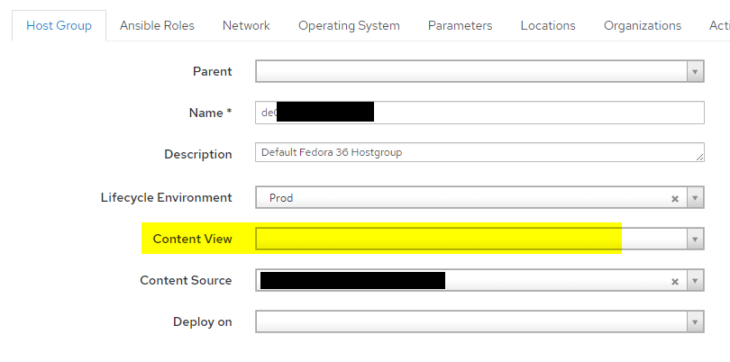

Hello ekohl,
Thanks a lot for the quick response!
I have replaced “fail_and_exit(stdout_stderr)” by “log_and_say(:error, stdout_stderr, true, false)” and now the installer is working! Great!
But:
With Foreman 3.6.2 the auto discovery process fails. Its really a nightmare. Error: 422 undefined method
`[ ]´ for nil:NilClass
Foreman version: 3.6.2
Plugins:
foreman-tasks 7.2.1
foreman_ansible 11.2.0
foreman_bootdisk 21.0.4
foreman_discovery 22.0.4
foreman_remote_execution 9.1.0
katello 4.8.3

Now I get Oops, we’re sorry but something went wrong undefined method `assign_single_environment’ for nil:NilClass
I don’t understand the error message. Operating system, host group, kickstart, etc. are defined as usual and work without any problems with Katello 4.7.

With Foreman 3.6 and Katello 4.8 the hostgroup won’t save the Content View. Set the CV save it, reopen it. Lost again…

Did the update again from the beginning. Foreman 3.5 to 3.6 incl. the current /katello/4.8/katello/el8/x86_64 repository.
I’m starting to despair. From one mistake to another… It’s really frustrating!

Hostgroup - ContentView problem still exists (ContentView lost after saving)
