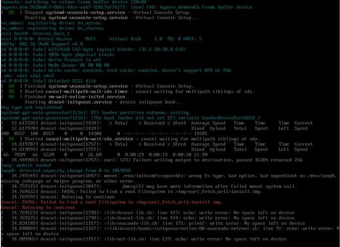

When I provision the VM I can get the default plymouth splash screen after the GRUB2 boot menu provides me the option to install via the Kickstart default selection. After that it goes through like it is going to continue with the install but shuts down before I can even read what is on the console screen. Is there some place I can look for logs other than “/var/log/foreman-proxy/proxy.log“ and “/var/log/foreman/production.log“ because I am not seeing any details there other than the provisioning token was successfully provided and that the dhcp ip is properly leased.

I was able to snag a pic before it shut down
To me, that looks like the system is having trouble downloading the installer image (or more specifically, the initramfs).
With the “failed writing output to destination” error, the first thing that comes to mind is: Do you have enough RAM in your target host? If I remember correctly, the netboot installer for EL Systems nowadays requires at least 4GB of RAM in the system you want to install.
Next thing I would check would be if the Installation Medium is properly configured and (if you are using a locally hosted one) if it might be corrupted.
Last thing that comes to mind is: Try downloading the installer files yourself via curl or similar from the installation medium path, ideally under the same network conditions as the host you are trying to install. Maybe there is some firewall problem going on or something is misconfigured on the Foreman end.
It was the ram thank you so much! I would have never thought. I always set debian systems to 2048 by default so I just imagined it would be the same.
