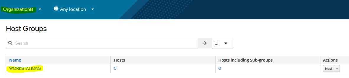

If it’s the case, if hostgroup are in fact global why when I list host groups I get the results which I mentioned in the previous post, so to better illustrate this problem:
If they are global I should see hostgroups even I switch to OrganizationA?
But it’s not the case.

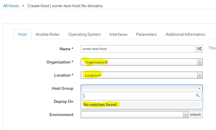

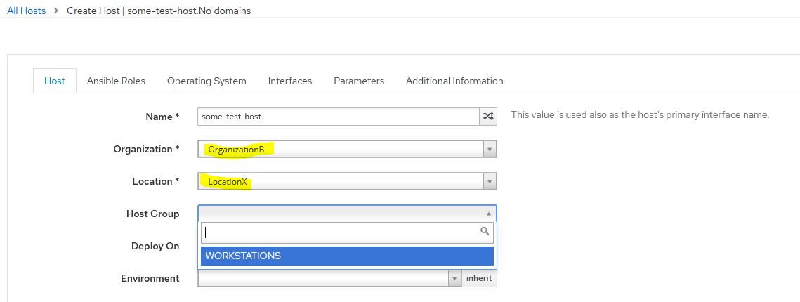

Moreover, why when I create a host and select an OrganizationB & LocationY I can see only 1 host group which was added specifically to that Org & location:
But If I change Location to some other to which I didn’t add any host groups I get no results:
Same thing when you try to change a host group for an existing host…
There’s no cosnequence here. :exploding_head:

That depends. You should only see the hostgroups in the organizations they are assigned to. Is the workstations hostgroup assigned to OrganizationA?
If there are no hostgroups assigned to that location, why would they be listed?
What’s the point of assigning group to a Location or Organization if host groups are global?
It shouldn’t really matter.
They are global as in “their names have to be globally unique”. By assigning them to locations and organizations, you control where they are visible and therefore where they can be used.
