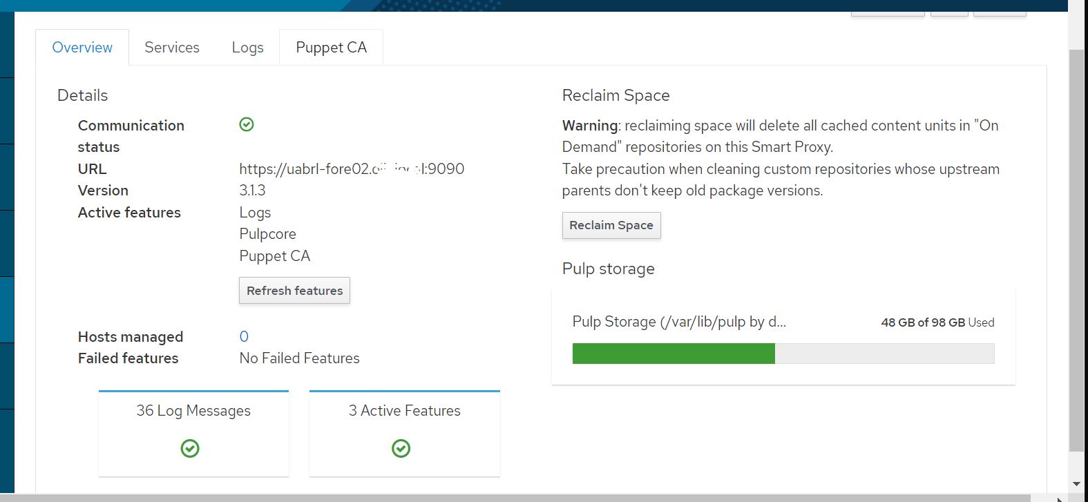

Is default configuration for the foreman smart proxy to use HTTPS?
Is the default configuration for smart-proxy when using the foreman-installer to put the smart-proxy behind https?
foreman-installer --enable-foreman-plugin-puppet --enable-foreman-cli-puppet --foreman-proxy-puppet true --foreman-proxy-puppetca true --foreman-proxy-content-puppet true --enable-puppet --puppet-server true
also should this and puppetserver running be enough to have an import classes button in foreman
Yes, https is default, only the template plugin enables both if I remember correctly.
Your installer options look correct, but the resulting proxy is missing Puppet, so an error should have occurred somewhere. The PuppetCA feature is only for certificate handling, Puppet is required for ENC and Import functionality.
So just curious do I attempt the foremain-installer again? I just tried that and see the same messages I saw before.
2022-10-06 09:01:40 [ERROR ] [configure] Proxy uabrl-fore02.olh.local has failed to load one or more features (Puppet), check /var/log/foreman-proxy/proxy.log for configuration errors
2022-10-06 09:01:40 [ERROR ] [configure] /Stage[main]/Foreman_proxy::Register/Foreman_smartproxy[uabrl-fore02.olh.local]/features: change from ["Logs", "Pulpcore", "Puppet CA"] to ["Logs", "Pulpcore", "Puppet", "Puppet CA"] failed: Proxy uabrl-fore02.olh.local has failed to load one or more features (Puppet), check /var/log/foreman-proxy/proxy.log for configuration errors
2022-10-06 09:01:43 [NOTICE] [configure] System configuration has finished.
  There were errors detected during install.
  Please address the errors and re-run the installer to ensure the system is properly configured.
  Failing to do so is likely to result in broken functionality.
  The full log is at /var/log/foreman-installer/katello.log
the proxy.log doesnt show any errors
katello.log shows the same error as above.
