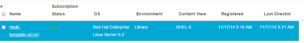

Now, I've managed to get the manifest imported, repositories synced etc.
and have also managed to get a server to register, see
However, whenever I try to do anything with Yum on the registered server, I
just get 403 Forbidden errors:

CentOS subscriptions are available, but the server is using a RHEL
subscription:
[johnb@rhel6-template ~]$ sudo subscription-manager list
··· +-------------------------------------------+ Installed Product Status +-------------------------------------------+ Product Name: Red Hat Enterprise Linux Server Product ID: 69 Version: 6.3 Arch: x86_64 Status: Subscribed Status Details: Starts: 12/15/2013 Ends: 12/15/2014
http://imgur.com/iwWqa3V
Just thought it’s worth stating that this host was previously registered
with Red Hat via RHN Classic. I did try the rhn-migrate-classic-to-rhsm
script, but couldn’t get it to work with my Katello 2.0 server…
> Just thought it's worth stating that this host was previously registered
> script, but couldn't get it to work with my Katello 2.0 server…
Ah sorry, I thought subscription-manager list --available would've show
the installed product too.
The subscription looks right. Date and time on the server match up with
the Katello server? Hostname didn't change or anything of the client?
And, is this machine actually RHEL 6.3? I wonder if it's something with
the subscription-manager version being compatible, we started testing
against 6.5 with Katello 2.0. That's just a guess, one of the other devs
might know if that would be a problem.
If you can get it back registered to RHN and update, I would try that
too.
