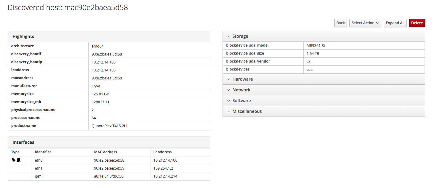

BTW, even after applying a patch (on 1.14), which helped tremendously, from
time to time I still get some duplicate entries caused by an already
discovered system trying to send its discovery payload. For whatever reason
though, Foreman discovery plugin does not recognize it as the same host and
creates a new entry in a DB with different ID:
<https://lh3.googleusercontent.com/-ouz9YJ25K5M/WdvXTxpj4lI/AAAAAAAAAEE/1LcC1bcM2PUzzuH3gQtTQuT0Bx7mFHKTQCLcBGAs/s1600/Screen%2BShot%2B2017-10-09%2Bat%2B12.59.22%2BPM.png>
The host in question keeps of retrying, of course, and gets 422 "Name
already taken" over and over again. My question though is why a duplicate
was created instead of updating an existing host? It seems to me that this
host was not recognized properly. A complete debug log of a operation, that
I believe resulted in above duplicate entry, is here -
I did not see any 422 error before this transaction so I think this is it.
Although I did not see any long MySQL queries, the whole transaction still
took ~11 seconds to complete for some reason:
2017-10-07 01:26:16 e3da2f90 [app] [I] Completed 422 Unprocessable Entity
in 11291ms (Views: 0.4ms | ActiveRecord: 172.9ms)

Hey
Name has already been taken - this usually means that host (either
discovered or managed or unmanaged) of that name "macXXXXXXXXX" already
exist. Same mac address? You can change easily how discovered hosts are
being named, by default it is "mac" + MAC address, you can change that to
random number or any different fact you want. See settings and our
documentation. Try to add a random number at the end if that helps.

Well, no, that's the same host. It was discovered at some point back (8
days ago as you can see in the screenshot above). Then it got
rebooted/crashed, PXE-booted again and started sending its discovery
payload again, but gets 422. Usually, if it is the same host, Foreman just

> If you visit the original discovery host in the UI, do you see
> Interfaces list? What MAC address is there? Is it detected as the
> primary interface there?
Yes, all of the data is in place for both duplicate entries and look
absolutely identical to me:
<https://lh3.googleusercontent.com/-Qjn-PntubGE/Wd5qYnQIQGI/AAAAAAAAAEU/nkbpCKnoFdwqGGRF-tWkEXyNK_SFRkq_gCLcBGAs/s1600/Screen%2BShot%2B2017-10-11%2Bat%2B11.57.26%2BAM.png>
<https://lh3.googleusercontent.com/-UJCurA1GVa4/Wd5qdFYOUaI/AAAAAAAAAEY/1f-YHzKHI1oNjbEj6_DZ8MAokTDO2zZqwCLcBGAs/s1600/Screen%2BShot%2B2017-10-11%2Bat%2B11.56.28%2BAM.png>

<https://lh3.googleusercontent.com/-wBk_VPoo0Fs/WfDA4guCc6I/AAAAAAAAAEs/ZIrmiIJEh64IGPxH0dz0y3aqO90F7WDdgCLcBGAs/s1600/Screen%2BShot%2B2017-10-25%2Bat%2B9.49.21%2BAM.png>
Ok this confirms it. Bug #21479: Multiple discovered hosts with same MAC address - Discovery - Foreman we will
fix later.
We don't have an unique index on DB level, just in Rails level and a second
NIC with same MAC can sneak in. The relevant code in core is:
validate :mac_uniqueness, :if =&gt; Proc.new { |nic| nic.managed? &amp;&amp;
nic.host && nic.host.managed? && !nic.host.compute? && !nic.virtual? &&
nic.mac.present? }
which will not trigger for Discovery at all (host is not managed). In
discovery we try to search for existing host and if not found, we will
create new discovered host. This does not work correctly, we have turned
off validator for some reason:
host.save(:validate =&gt; false) if host.new_record?
So the validation for uniqueness won't hit.
