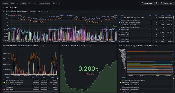

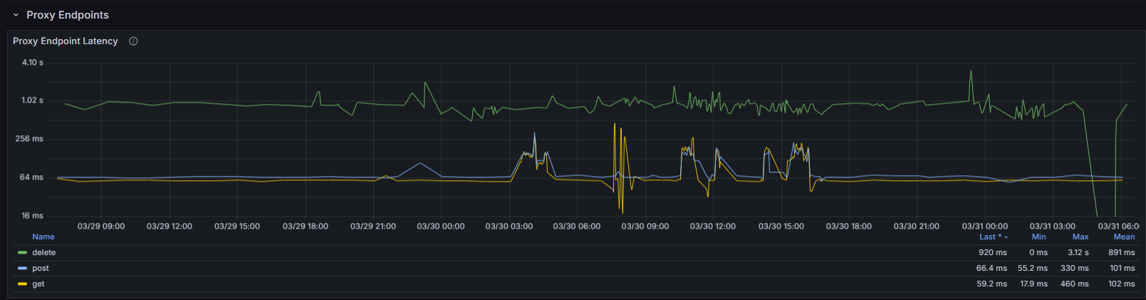

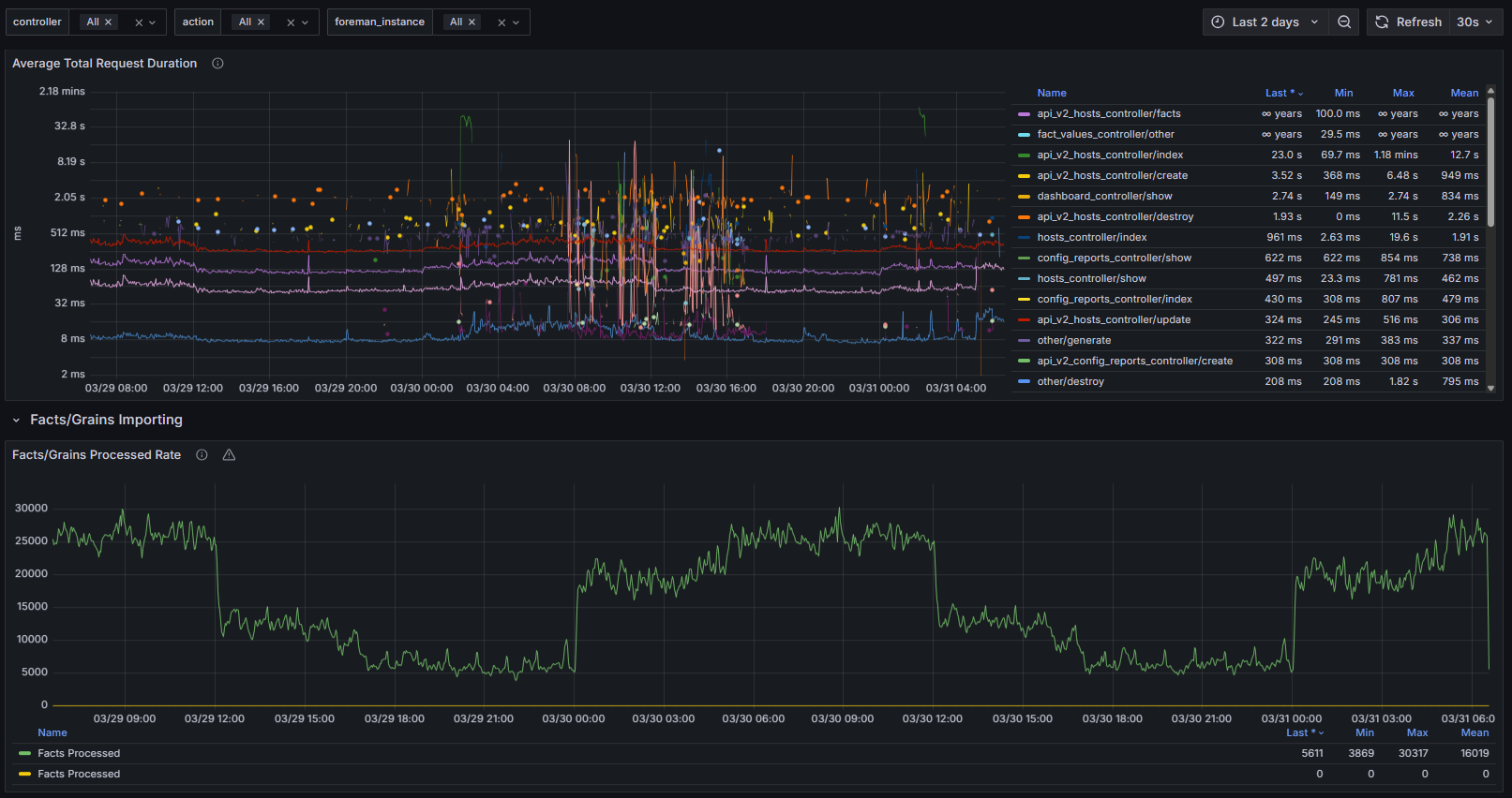

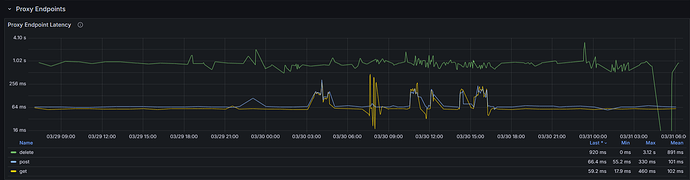

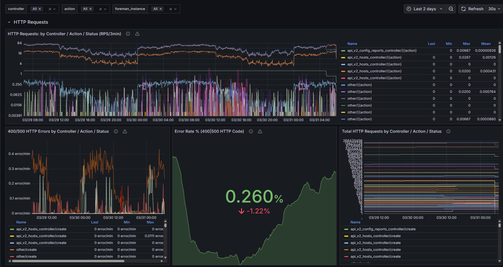

I looked at PCP, and said nope. I am using the built in telemetry. Which isnt as much as I want, but its plenty to monitor and alert on performance issues:
