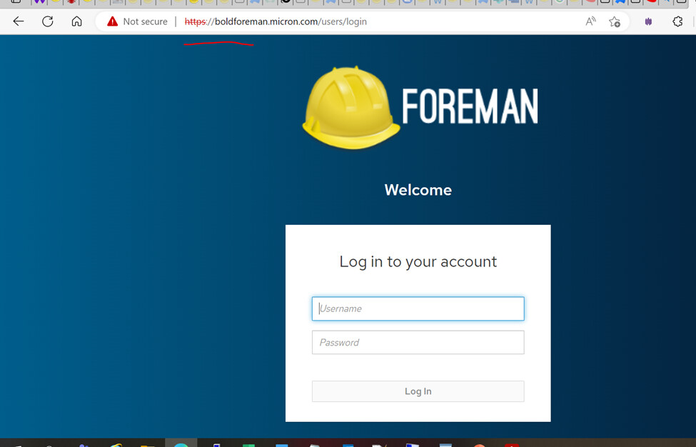

Not secure connection with https://boldforeman.micron.com, required document
Problem: foreman URL is Not secure
Expected outcome: i want to access via https://boldforeman.micron.com
**Foreman and Proxy versions:**3.3
**Foreman and Proxy plugin versions:**3.3
**Distribution and version:**3.3
  1. Upgrade. 3.3 is outdated.
  2. What is the exact reason why it’s not trusted?
  3. If you did not set custom ssl certificates, but only generated self-signed certificates you have to trust the certificate in your browser.
  4. If you want to use custom ssl certificates follow the docs Installing Foreman 3.3 Server with Katello 4.5 Plugin on RHEL/CentOS
  1. What is the exact reason why it’s not trusted?

Sorry, but then you’ll have to tell how exactly you have configured those certificate using foreman-installer.
If that micron certificate is not from a public ca which is part of the trusted roots, i.e. if that certificate is a root ca certificate not generally trusted, only then you may have to add to the trusted roots.
However, you don’t have to add it on the server but on the client. If it’s an untrusted root ca you’ll have to add it to your browser to accept and trust it. Otherwise, the browser will always consider it not secure because the certificate has not been issued by a PKI signed by a trusted root ca…
