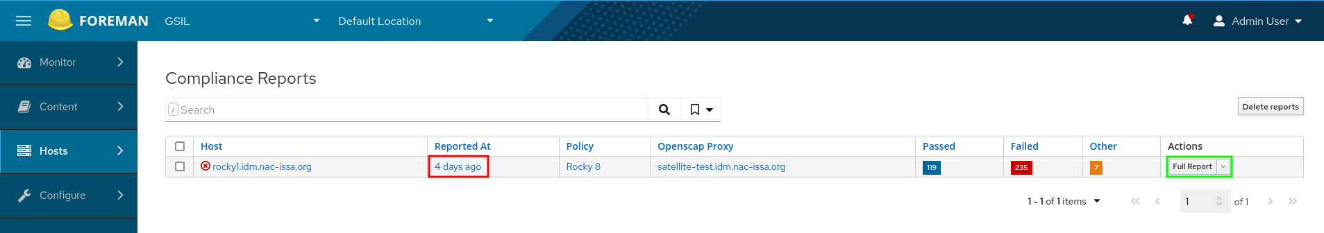

Click on the reported at information to get into the report detail page. This is how it looks like

Here are my screenshots. I am visiting the page as an admin user. I think I may have listed the wrong version (as 1.0) based on the plugin documentation page.

ARF Report1
ARF Report2
I see. You clicked on the Full Report instead of the reported at. Click on the link marked as a red rectangle, don’t click on the button marked as green rectangle
That’s it! You pointed me to the correct area to click on and now I see the buttons you reference.
