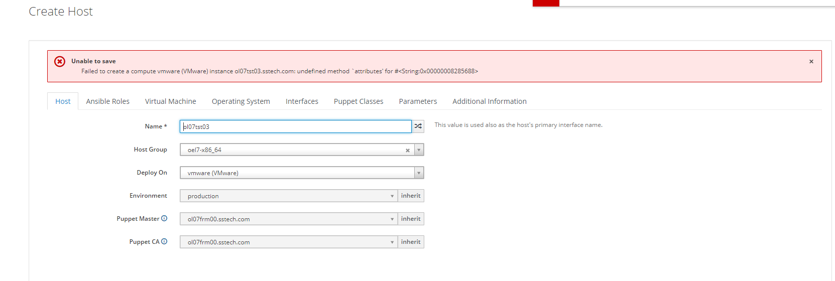

My foreman (katello) is integration with vmware (OVH). When create new host this error present:
Failed to create a compute VMWARE (VMware) instance myhost.domain.com: undefined method `attributes’ for #String:0x007fd2e4e9c3c0
My integration with vmware be user root.
Whats the problem ? How to resolution?

I have also same issue with foreman 1.17.
I got below error
I created user with administrator previliges in vcenter server. I’m using vcsa 6.5

2018-05-04 10:40:39 d4dda2bd [app] [W] Rolling back due to a problem: [#<Orchestration::Task:0x007f40204653e0 @name="Set up compute instance ol07tst01.sstech.com", @status="failed", @priority=2, @action=[#<Host::Managed id: nil, name: "ol07tst01.sstech.com", last_compile: nil, last_report: nil, updated_at: nil, created_at: nil, root_pass: "$5$08pUFqDz$UcKLPf0DlgqrYIyeYJKbSuiamsITZRmamfklJF...", architecture_id: 1, operatingsystem_id: 2, environment_id: 1, ptable_id: 101, medium_id: 9, build: true, comment: "", disk: "", installed_at: nil, model_id: nil, hostgroup_id: 1, owner_id: 4, owner_type: "User", enabled: true, puppet_ca_proxy_id: 1, managed: true, use_image: nil, image_file: nil, uuid: nil, compute_resource_id: 2, puppet_proxy_id: 1, certname: nil, image_id: nil, organization_id: nil, location_id: nil, type: "Host::Managed", otp: nil, realm_id: nil, compute_profile_id: nil, provision_method: "build", grub_pass: "$6$5jGIrNeB$/D7.QdcTHpaZq.TQpv1F4T4kaCYpkcX8kcsu4V...", global_status: 0, lookup_value_matcher: "fqdn=ol07tst01.sstech.com", pxe_loader: "PXELinux BIOS", expired_on: nil>, :setCompute], @timestamp=2018-05-04 14:40:39 UTC>]
2018-05-04 10:40:39 d4dda2bd [app] [I] Processed 1 tasks from queue 'Host::Managed Main', completed 0/7
2018-05-04 10:40:39 d4dda2bd [app] [E] Task 'Set up compute instance ol07tst01.sstech.com' *failed*
2018-05-04 10:40:39 d4dda2bd [app] [E] Task 'Query instance details for ol07tst01.sstech.com' *canceled*
2018-05-04 10:40:39 d4dda2bd [app] [E] Task 'Create DHCP Settings for ol07tst01.sstech.com' *canceled*
2018-05-04 10:40:39 d4dda2bd [app] [E] Task 'Deploy TFTP PXEGrub2 config for ol07tst01.sstech.com' *canceled*
2018-05-04 10:40:39 d4dda2bd [app] [E] Task 'Deploy TFTP PXELinux config for ol07tst01.sstech.com' *canceled*
2018-05-04 10:40:39 d4dda2bd [app] [E] Task 'Deploy TFTP PXEGrub config for ol07tst01.sstech.com' *canceled*
2018-05-04 10:40:39 d4dda2bd [app] [E] Task 'Fetch TFTP boot files for ol07tst01.sstech.com' *canceled*
2018-05-04 10:40:39 d4dda2bd [app] [I] Failed to save: Failed to create a compute vmware (VMware) instance ol07tst01.sstech.com: undefined method `attributes' for #<String:0x007f40205ad450>
