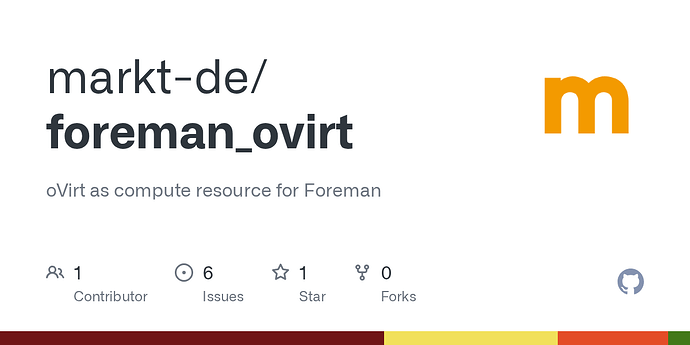

We’ve created a plugin:
It’s based on Foreman 3.15.0 and mostly a 1:1 port of the old core code.
The plugin is functional. The most notable change is a new ā€œoVirtā€ card on the host details page.
Some tasks are still pending, but we’ll try to complete them in-time for Foreman 3.16.0. If someone would be willing to provide a DNF/APT repository, this would be awesome.
Please give it a try. (It requires Foreman 3.16, so use the develop branch.)
Feedback, contributions, collaboration, etc. is always welcome. Please have a look at the open tasks:
This code ensures that the oVirt data is NOT removed from the Foreman database when upgrading to 3.16.0. I’m not sure if this is the best approach, so any feedback would be appreciated.
