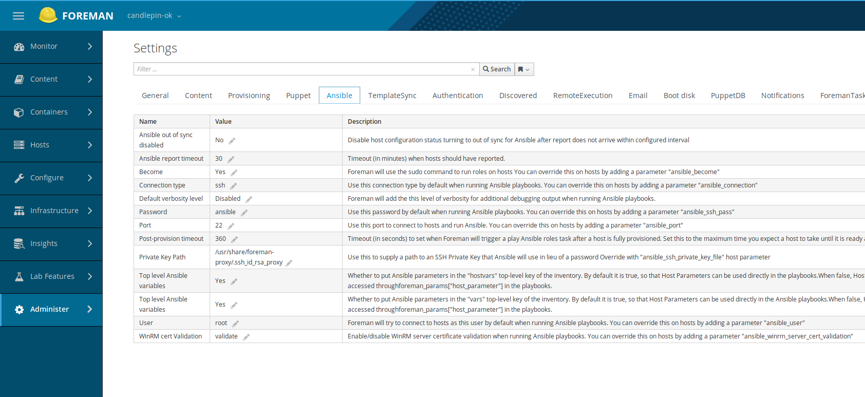

I think you’re right. The screenshot doesn’t show the setting “Private Key Path” which was a bug we had in previous versions of Foreman Ansible.
@Ji1990 You can do what @aruzicka mentioned, try putting the key in there. However I would recommend updating to the most recent version so the key is correct, plus you will get some other important bugfixes. It should be a matter of ‘yum update tfm-rubygem-foreman_ansible’ and restarting the server
As you can see here, you should be able to choose the location of the SSH key (defaults to what you put on your original post):
Aside from that, I think you are missing FOREMAN_SSL_VERIFY in the callback configuration. You can set the path to the CA (/etc/puppetlabs/puppet/ssl/certs/ca.pem I think) or disable it (False). One of the two is necessary unless your puppet CA is included in the system CA bundle which I doubt.

I am not sure how you have so many available settings in the Ansible tab of the GUI.
The repository it is using is http://yum.theforeman.org/plugins/1.17/el7/x86_64/. I am not sure where I can find a newer version of the plugin. yum install/update doesn’t let me update the packages as these are the latest ones available in the repository.

@Ji1990 Oh - I realized now.
was not merged to 1.17. I only see it on nightly.
About changing the SSH key path, can you try to add a parameter to your host (or a global parameter, or a host group parameter) in Foreman: ‘ansible_ssh_private_key_file’ : ‘/usr/share/foreman-proxy/.ssh/id_rsa_foreman_proxy’ ?
I am testing this on nightly now and everything works fine out of the box, except for a thing I’m debugging (/usr/share/foreman-ansible/ansible.cfg is ignored and only /etc/ansible/ansible.cfg is used) but hopefully with the host parameter you can get by until 1.18 comes out?
@packaging is there any reason why that could not be merged to 1.17? Maybe it’s because it contains the webpacked assets.
Correct, in 1.17 we couldn’t deal with webpack in plugins. 1.18 should contain all the fixes needed.
