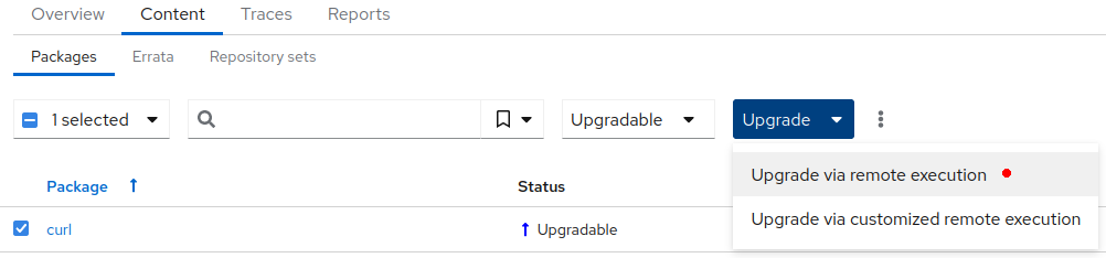

Start any REX job, e.g.:
The REX job, and the resulting error:
