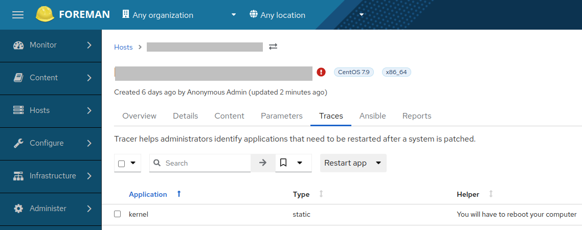

There are a few managed hosts in Foreman, where Foreman tells me that a reboot is required.
Foreman obviously relies on “Traces” (which are installed on both Foreman and managed hosts).
When I use “Traces” in Foreman to resolve and reboot, the system reboots, but after the reboot, the status is still the same - Reboot Required.

this is what I get:
==> /var/log/httpd/foreman-ssl_access_ssl.log <==
10.11.12.13 - - [07/Sep/2023:21:26:11 +0200] "PUT /rhsm/consumers/ebd7540f-48d5-4f27-875e-e1c7e4358c60/tracer HTTP/1.1" 200 57 "-" "RHSM/1.0 (cmd=katello-tracer-upload)"
==> /var/log/foreman/production.log <==
2023-09-07T21:26:11 [I|app|a04e45a1] Started PUT "/rhsm/consumers/ebd7540f-48d5-4f27-875e-e1c7e4358c60/tracer" for 10.11.12.13 at 2023-09-07 21:26:11 +0200
2023-09-07T21:26:11 [I|app|a04e45a1] Processing by Katello::Api::Rhsm::CandlepinProxiesController#upload_tracer_profile as JSON
2023-09-07T21:26:11 [I|app|a04e45a1]   Parameters: {"traces"=>{"kernel"=>{"type"=>"static", "helper"=>"You will have to reboot your computer"}}, "id"=>"ebd7540f-48d5-4f27-875e-e1c7e4358c60"}
2023-09-07T21:26:11 [I|app|a04e45a1] Completed 200 OK in 41ms (Views: 0.1ms | ActiveRecord: 9.5ms | Allocations: 14829)
