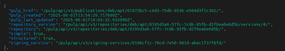

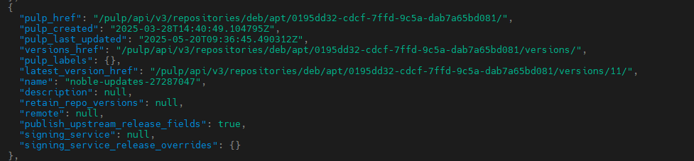

Hi quba42,
I have check the repository and publication list.
In the repo list, the signing_service is ‘null’ where it is referencing my katello_deb_sign in the publication list.
repo list
publication list
