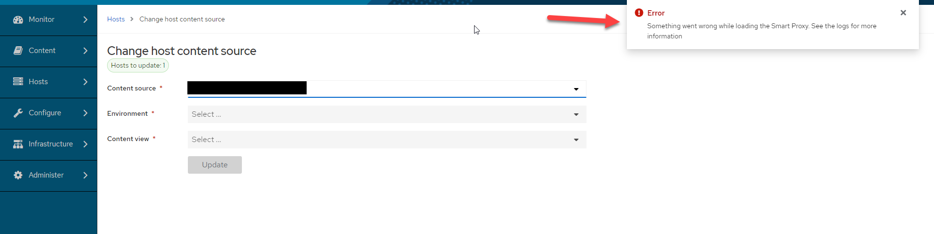

Problem: Unable to change Content Source from endpoint hosts, when trying to switch via the foreman GUI under Hosts > Change host content source it keeps giving me an error when selecting alternate content source.
Expected outcome: Ability to change content source
foreman-release-3.5.1-1.el8.noarch
katello-4.7.2-1.el8.noarch
All packages latest 3.5.x and 4.7.x
RHEL 8.7
When I select the endpoint and try switchin the content source to a diffent one I keep getting the following error:
Something went wrong while loading the Smart Proxy. See the logs for more information
Under the foreman node production.log shows the following:

I am still not sure why changing content source to a different proxy is not working as intended, perhaps is a bug somewhere…I know this worked in the past but didnt track how far back this was working since now I am running the latest released. Below is another copy of the error via production.log.
