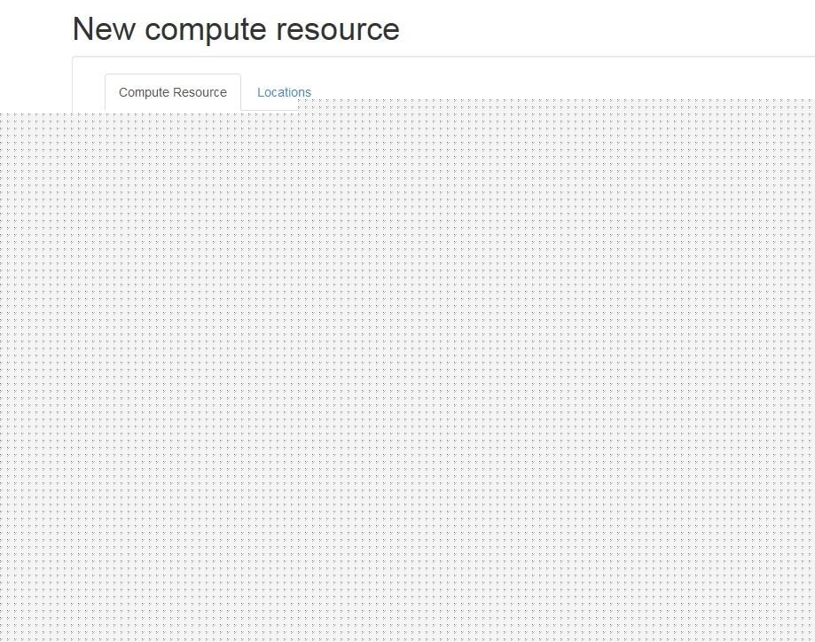

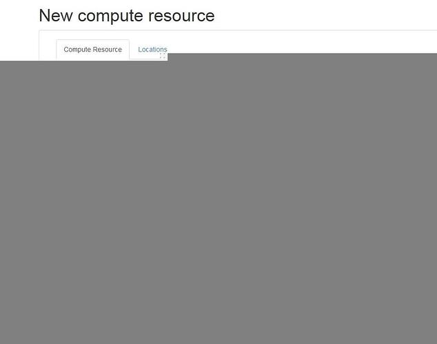

I created a new Client ID/Email in GCE Console's Credentials screen and
selected the "service account" type. This prompts me to save a .p12 file
with a passphase of "notasecret" to my computer.
I copy the *email *address associated with the new cliend ID that's already
been given "edit" permissions to my project
I fill in the compute resource details on my Foreman and add in the path to
the .p12 file I downloaded just a second ago but when I go to load the
Zones I get the error message shown in the attached file and if I try to
save I get the "Invalid keyfile or passphrase".
Is the passphrase set somewhere in foreman?
··· On Friday, February 21, 2014 2:10:40 PM UTC, Michael. OBrien wrote: > > I got the message "Unable to save" "Invalid keyfile or passphrase" > > > > *From:* foreman-users@googlegroups.com [mailto: > foreman-users@googlegroups.com] *On Behalf Of *Laurent Salut > *Sent:* 21 February 2014 14:05 > *To:* foreman-users@googlegroups.com > *Subject:* [foreman-users] Re: Unable to create a host on GCE > > > > I didn't get problem with this part. What does foreman say ? > I put the e-mail which you get on the google developpers console and the > p12 file. > > -- > You received this message because you are subscribed to a topic in the > Google Groups "Foreman users" group. > To unsubscribe from this topic, visit > https://groups.google.com/d/topic/foreman-users/scWe0wVx7fg/unsubscribe. > To unsubscribe from this group and all its topics, send an email to > foreman-users+unsubscribe@googlegroups.com. > To post to this group, send email to foreman-users@googlegroups.com. > Visit this group at http://groups.google.com/group/foreman-users. > For more options, visit https://groups.google.com/groups/opt_out. >
