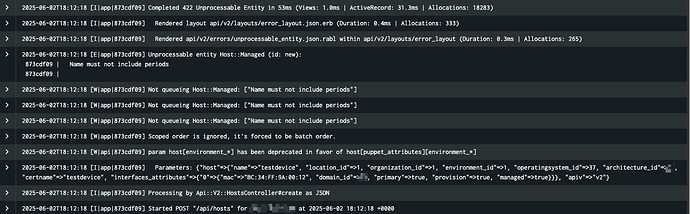

When you try to create a host with the API, what does the incoming api call + traceback look like in `/var/log/foreman/production.log
Here’s the actual logs from the API request
That is really odd, I don’t see any thing that looks odd in what the server received. Do you get the same error from hammer or from the UI?
I do get the same error in the UI.
