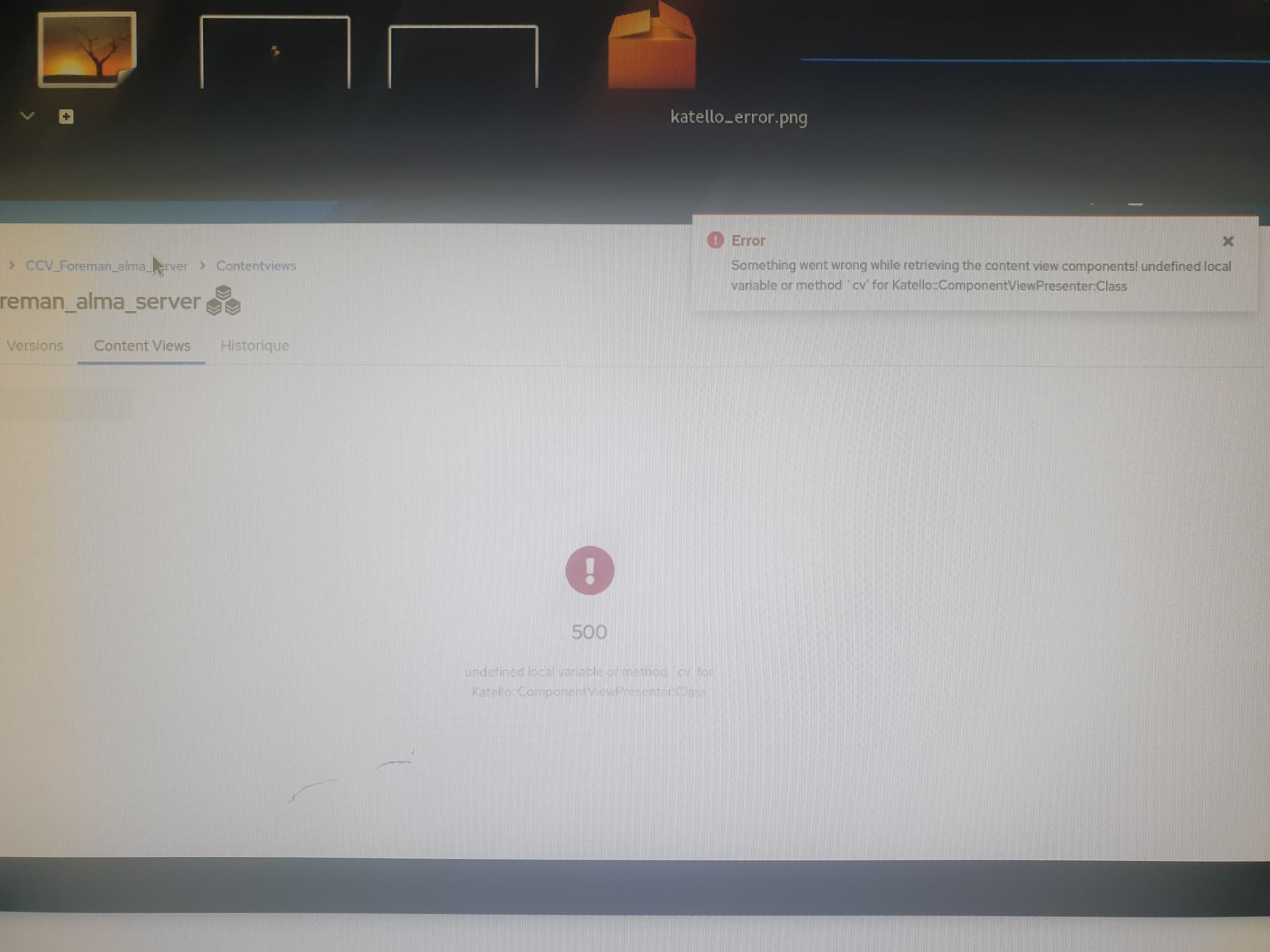

I Cannot acces to web page where i can add content-view to a composite content-view , It displays the error message bellow :
Something went wrong while retrieving the content view components! undefined local variable or method `cv’ for Katello::ComponentViewPresenter:Class

Hey @siriwliw :
Could you also provide the foreman logs when you see this error?
Also, if possible can you also paste the details of the failed call in the network tab of the log of the browser when you land on this page?
Never mind! We were able to identify the root cause. It’s to do with translations and how the value is passed to the API from the translated UI. Thanks for raising this @siriwliw !

So, do I need to update my server to apply the latest correction ? Or just modify these files “ContentViewsConstants.js” “component_view_presenter.rb” as indicated in this Github link : https://github.com/Katello/katello/pull/9859/files ?
The javascript part of the patch might not help locally as installed katello instances use a pre-compiled version. However, the .rb file changes should be ok to apply and restarting the server should bring in that fix. The .rb fix should unblock you while 4.3 is packaged and goes GA.

@siriwliw : Just remembered a more straight-forward way to get you unblocked.
The old UI is still available at https://yourserver.com/legacy/content_views .
You can use that for this particular task while we get the fix released in 4.3 GA.
Hi @sajha
I have tested your solution and I confirm that it works perfectly on my katello server, thank you !
