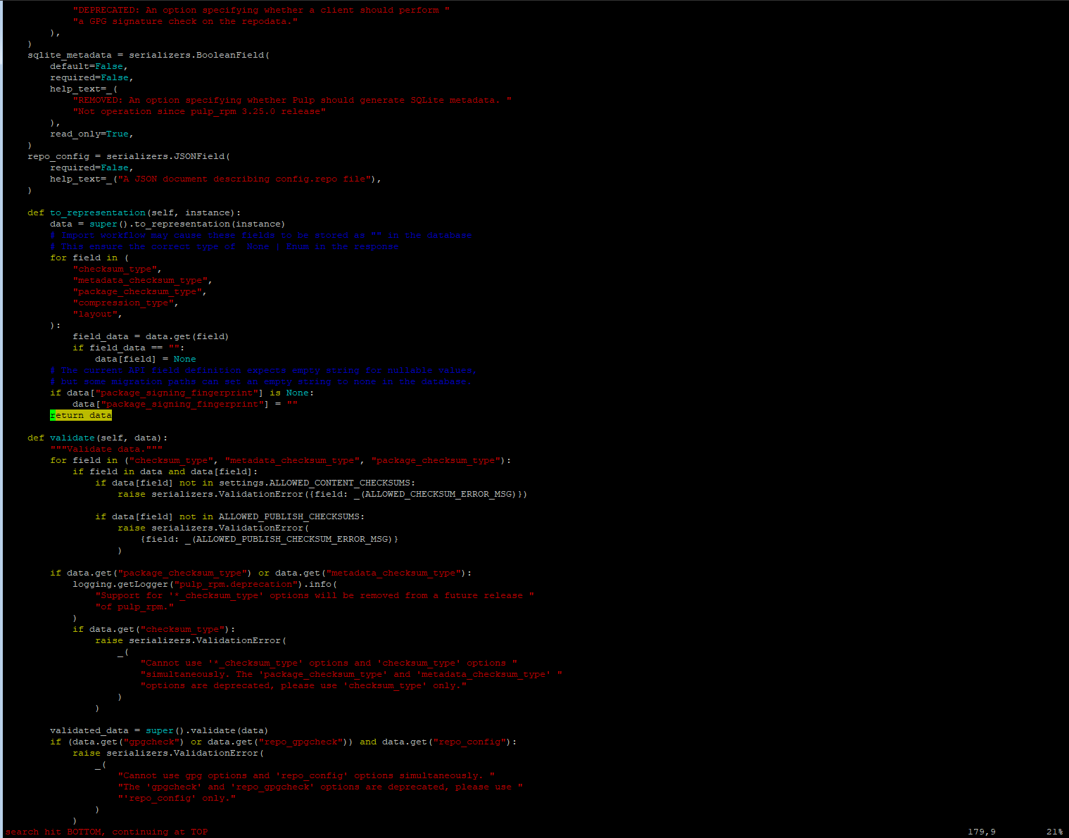

What i did, which also applies to new CV/CCV’s but would (should) be overwrote when you do an upgrade, is edit the python file that is parsed through:
edit
Make a copy of the original file, for easy safe keeping:
cp /usr/lib/python3.12/site-packages/pulp_rpm/app/serializers/repository.py ~/repository.py
Edit this file:
sudo vim /usr/lib/python3.12/site-packages/pulp_rpm/app/serializers/repository.py
Navigate to line 179, or find this specific piece of code the first occurance:
return data
like the PR does, we add to def to_representation(self, instance): an if statement to make the "package_signing_fingerprint" return an empty string, rather then NULL.
Just above the return, we add this:
        # The current API field definition expects empty string for nullable values,
        # but some migration paths can set an empty string to none in the database.
        if data["package_signing_fingerprint"] is None:
            data["package_signing_fingerprint"] = ""
You should have something like so:
Once that’s inplace, save and restart foreman so that any edits to the python file are also taken in: foreman-maintain service restart
Navigate to your (C)CV that is bugged. Do make sure to publish & promote the one where you still have packages in it!
Also, if you have troubles removing the invalide content-view, first try to
stop the current promotion, i had to force unlock and then cancel/resume it. If you have your OTAP environment on that bugged version withoud packages in it, promote and publish an older version to your OTAP line, that way you still have a working version published. You can do this by clicking the 3 dots next to the previous version with packages in it.
Once you have a properly clean (C)CV, try a manual publish and promote, it should work withoud any issues!

Hi @orelops , that looks like a different issue. If you can pull out the Pulp stacktrace with the error, it might be good to file it as a bug in the appropriate Pulp plugin (likely Pulpcore or RPM depending on where the stacktrace originates).
Hi Team, I upgraded to the latest code 4.17 along with respective Katello…I am getting the following while doing a proxy sync:
package_signing_fingerprint cannot be nilpackage_signing_fingerprint cannot be nilpackage_signing_fingerprint cannot be nilpackage_signing_fingerprint cannot be nilpackage_signing_fingerprint cannot be nilpackage_signing_fingerprint cannot be nilpackage_signing_fingerprint cannot be nilpackage_signing_fingerprint cannot be nilpackage_signing_fingerprint cannot be nilpackage_signing_fingerprint cannot be nilpackage_signing_fingerprint cannot be nilpackage_signing_fingerprint cannot be nilpackage_signing_fingerprint cannot be nilpackage_signing_fingerprint cannot be nilpackage_signing_fingerprint cannot be nilpackage_signing_fingerprint cannot be nilpackage_signing_fingerprint cannot be nilpackage_signing_fingerprint cannot be nilpackage_signing_fingerprint cannot be nilpackage_signing_fingerprint cannot be nilpackage_signing_fingerprint cannot be nilpackage_signing_fingerprint cannot be nilpackage_signing_fingerprint cannot be nilpackage_signing_fingerprint cannot be nilpackage_signing_fingerprint cannot be nilpackage_signing_fingerprint cannot be nilpackage_signing_fingerprint cannot be nilpackage_signing_fingerprint cannot be nilpackage_signing_fingerprint cannot be nilpackage_signing_fingerprint cannot be nilpackage_signing_fingerprint cannot be nilpackage_signing_fingerprint cannot be nilpackage_signing_fingerprint cannot be nilpackage_signing_fingerprint cannot be nilpackage_signing_fingerprint cannot be nilpackage_signing_fingerprint cannot be nilpackage_signing_fingerprint cannot be nilpackage_signing_fingerprint cannot be nilpackage_signing_fingerprint cannot be nilpackage_signing_fingerprint cannot be nilpackage_signing_fingerprint cannot be nilpackage_signing_fingerprint cannot be nilpackage_signing_fingerprint cannot be nilpackage_signing_fingerprint cannot be nilpackage_signing_fingerprint cannot be nilpackage_signing_fingerprint cannot be nilpackage_signing_fingerprint cannot be nilpackage_signing_fingerprint cannot be nilpackage_signing_fingerprint cannot be nilpackage_signing_fingerprint
I can confirm this is working, but the patch needs to be apply to all the proxies as well…dont forget that.
Hi, When will the fixed rpm be released to the repository?
For me, this workaround fixed it and was the easiest to apply short term:
Then run the installer again to complete the upgrade which then finished successfully
pulp-rpm-3.29.4 was just released pulp-rpm·PyPI
We should be able to get this packaged into the pulpcore repository soon for installation outside of a normal Katello upgrade.
When it pops up - follow the usual Foreman patch upgrade steps. Technically there only needs to be a service restart of Pulp since there wasn’t a migration.
Here is the new package: https://yum.theforeman.org/pulpcore/3.73/el9/x86_64/python3.12-pulp-rpm-3.29.4-1.el9.noarch.rpm
has this been confirmed as working properly?
thanks
thank you for this. Does it need fixing on any smart proxies too, or is the master enough. I ran it on the master and sync worked fine, as did the publish, but then thought the proxies might need a fix
i upgraded this morning, I tested the usual stuff, content sync (AlmaLinux 8,9,10 and other repos), creating CV, updating hosts and did a host registration for test, works fine.
upgraded the pulp rpm, you mean?
No, it was a complete upgrade, i never leave my foreman install in a half broken state and hope for a fix. Today i did a normal upgrade after seeing the post from iballou, no need to pick the pulp rpm because its already in the repos. If you are already on 3.15/4.17, a dnf upgrade should pull the rpm.
Okay thanks. Wasn’t aware it has been officially released yet,only saw the downloadable pulp rpm above. Will check dnf now
I’ve updated using dnf to grab that package. There’s no mention of it being needed for any smart proxies (they also contain that same DB), but I also don’t see a package update for them, so looks like the fix is just on the master instance
