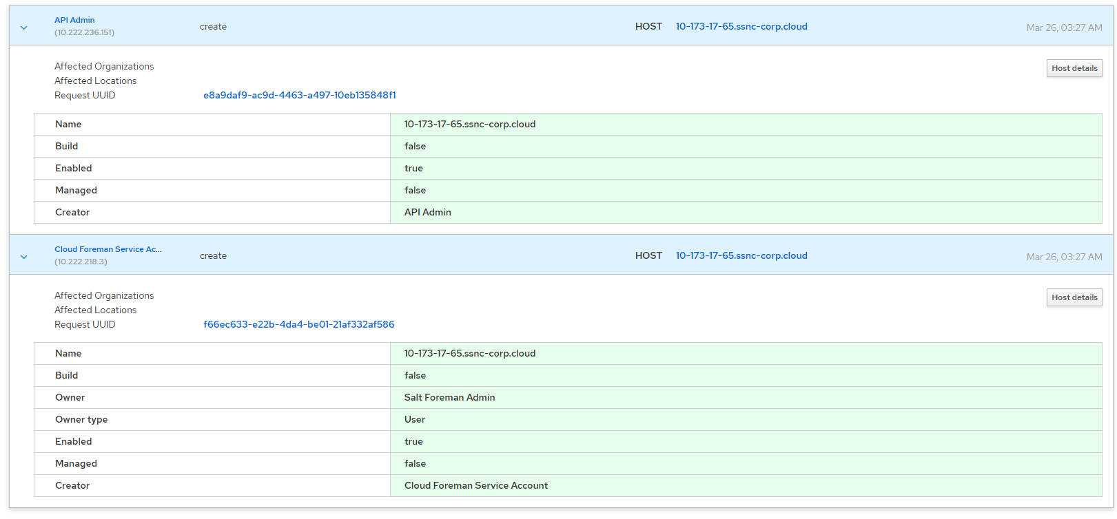

Another case of duplicated hosts
Hosts with the exact same fqdn get duplicated.
Only 1 host with the same fqdn should ever be created.
How is this possible?
What in the world does Foreman use to determine uniqueness of a host? Should it not be the fqdn?
So, we today discovered another duplicate host on our 3.9 instance, too. This time the creation of the duplicate host was recent enough that I still hat the corresponding logs and I could narrow down where things are going wrong, though I have now clue as to why it is going wrong.
In our case, the issue occured on a config (in our case Puppet) report upload, though as far as I can tell, all config management systems use the same logic in the relevant spots, so it should be identical for salt. There is also nearly identical behavior for fact imports.
Here is what I found in our logs:

Thanks for the response. Glad to see Im not the only one having this issue.
One thing we did was disable fact import host creation, and left report import host creation enabled. With this running for 2 days, we did not see a single duplicated host. We then disabled report host creation and enabled fact import host creation. Immediately we saw dozens of duplicate hosts coming in. So it must be somewhere in the fact importer. In our case, we dont really want to go down the rabbit hole of modifying foreman source code, thus we are going to likely put in guardrails and additional checkers in our fact upload script. Its not ideal, because now for every single host that runs salt (around 90,000 a day), we’ll have to have one additional API call that checks to see if the host exists in Foreman or not.
