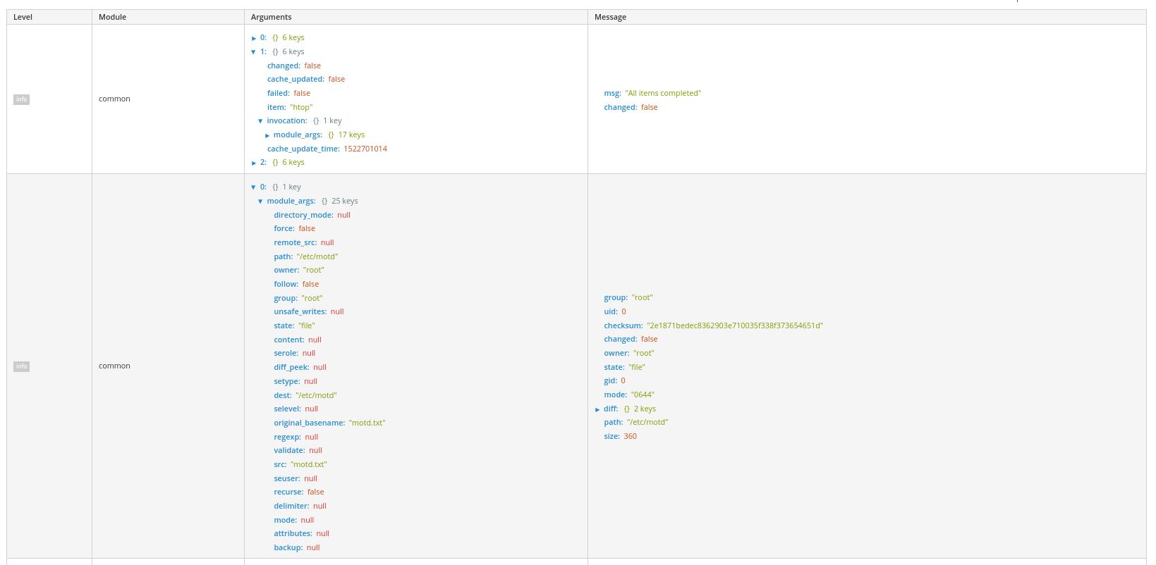

We are working on improving integration with Ansible, which also includes making reports better readable. In 1.18 we’ll introduced a JSON viewer which let’s users browse through the JSON better:
This is not the golden solution, but an improvement. Any feedback and suggestions on what and how reports should be presented can help find a better solution.
Regarding the issue with gathering facts from Windows machines might be worth a separate thread.
Looks fine to me, I’m looking forward to test the next release :grinning:
I think the changed true/false could be a gray label Unchanged or green label Changed. Makes it much easier to quickly see what changed. Exact colors should be determined by someone who does have a feeling for UI/UX :stuck_out_tongue: Perhaps it could be shown together with the level?
I also wonder if Message should be before Arguments since as a user I might look at that first.

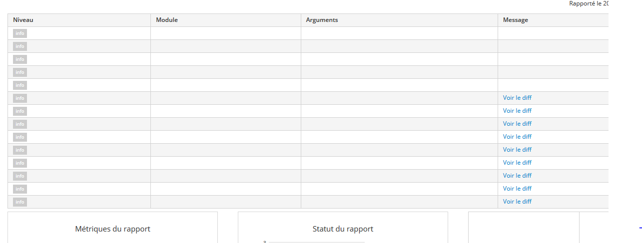

When I launch a playbook, my reports are empty :
I used :
ansible-2.6.2
foreman-1.18.0-2
tfm-rubygem-foreman_ansible_core-2.0.2-1.fm1_18
tfm-rubygem-foreman_ansible-2.2.5-1.fm1_18
this looks as another issue with json tree react component / webpack, could you check JS console in your browser if there’s some error?
For some I’ve :
TypeError: o is null
or some I’ve :
Error: Component not found: ReportJsonViewer among BookmarkContainer, DonutChart, StatisticsChartsList, PowerStatus, NotificationContainer, ToastNotifications, StorageContainer, PasswordStrength, BreadcrumbBar
and:
