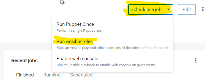

I know that I can import a playbook/role to foreman, then assign that playbook to a host. Then execute them by using a Schedule a job button from which I select “Run Ansible Roles”
But this will execute ALL ansible roles which are associated with that host. I don’t want that.

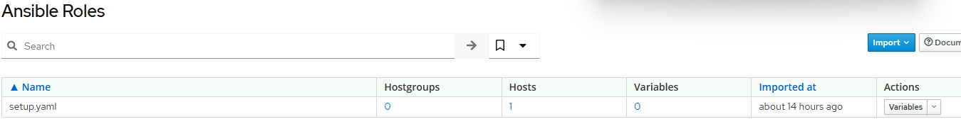

I think there was some kind of misunderstanding. I am refferring to the Ansible roles import:
Like above, I imported setup.yaml and assigned it to 1 host.
It doesn’t matter if it’s single playbook like setup.yaml or real role. Let’s assume that I assigned 10 real roles (not playbooks) to a host.
Now, after clicking the “Schedule a job” button I have an option to “Run Ansible roles”. All of them, I don’t want that. I want to be picky and select only roles X,Y,Z. Is it possible with Foreman? I don’t know if it’s gonna help me because I am not using roles at all, but playbooks.

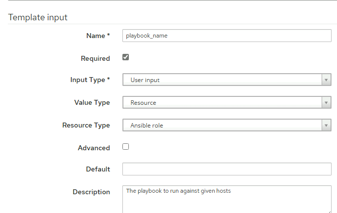

Something like this could work
- ansible.builtin.import_playbook: /etc/ansible/playbooks/<%= input_resource('playbook').name %>
As long as the playbook input is a user input of value type resource and resource type ansible role just as you have in the original post.

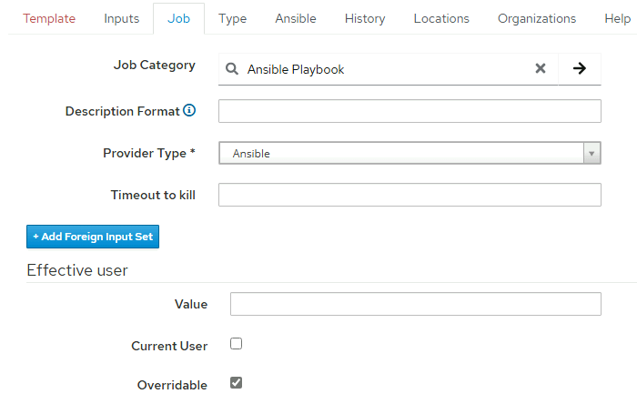

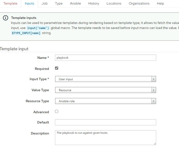

It doesn’t work because when resource type is provided foreman retrieves an ID of that resource, and you cannot access that resource details because safe mode is enabled (that’s by default).
  1. Playbook setup.yaml is imported:
  2. Job template defined as following:

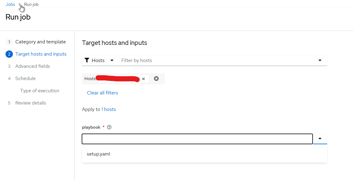

  3. Playbook execution, I can select playbook from the list
After executing it I got following error:
Failed to initialize: RuntimeError - Failed rendering template: error during rendering: Safemode doesn’t allow to access ‘role_name’ on #Safemode::ScopeObject

If you have everything configured as shown on the screenshots, you shouldn’t get an error about calling role_name as nothing should be calling role_name on anything. Now that the other thread is more or less settled, could you double check on your end? This seems to work on my machine
