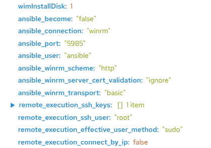

When looking at the inventory, ansible_password is not included indeed:
Even I have a same issue, are you able to figure out any solution ?
@amgokak - no, not really - ansible_password is still filtered.
I moved away from basic auth winrm; this is the right choice I guess (only wanted to give it a quick test).

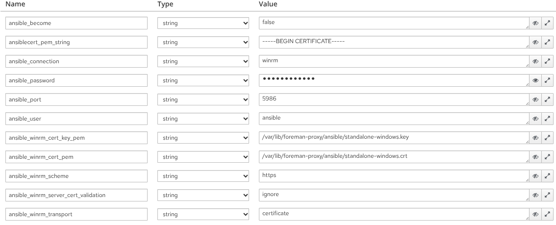

These are my hostgroup vars; they shoud get you started. Keep in mind:
  • ansiblecert_pem_string is the content of ansible_winrm_cert_pem
  • The forman_proxy user can read both cert files
  • If you have any suggestions - reply back here!
