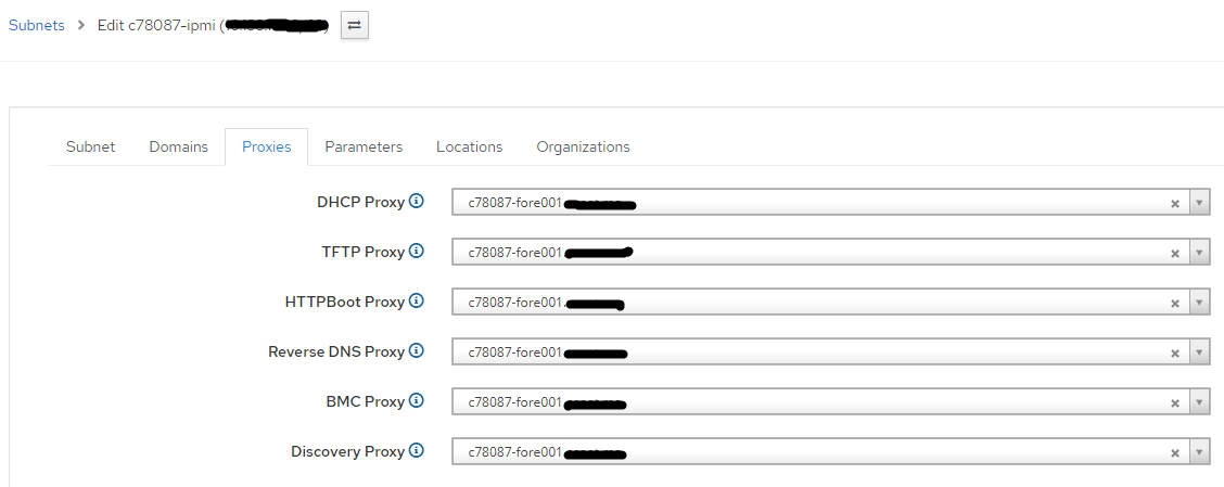

In 2.2 we have changed how BMC proxy is found. Previously it was any proxy with BMC features, now it is BMC proxy you have associated with your subnet.
https://projects.theforeman.org/issues/28357
Solution: Associate BMC proxies with your subnets.

[Foreman::BMCFeatureException]: There is no proxy with BMC feature set up. Associate a BMC feature with a subnet.
Even when I went to the subnet and Smart Proxy pages, there was no error / message / indicator that this was not configured.
I’ll look into it again.

I am a bit confused on if there is a specific way to associate the proxy with the BMC subnet. In Foreman, the “BMC Proxy” is already configured for all of my subnets - including adding a new subnet to Foreman for the BMC addresses (in case that was needed).
The Smart Proxy and Foreman server are the same system - there are no dedicated Smart Proxies doing BMC.

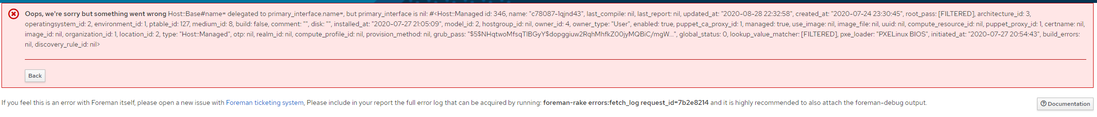

Pictures and backtraces attached.
[root@c78087-fore001 ~]# foreman-rake errors:fetch_log request_id=55a6fb45
2021-04-15T17:20:50 [I|app|55a6fb45] Started PATCH "/hosts/346" for 127.0.0.1 at 2021-04-15 17:20:50 -0400
2021-04-15T17:20:50 [I|app|55a6fb45] Processing by HostsController#update as */*
2021-04-15T17:20:50 [I|app|55a6fb45]   Parameters: {"utf8"=>"✓", "authenticity_token"=>"mpM3YsBzz/cW6x5ksslzrE9OqsodNrcUGm0Ct2lGk75hLZMaBMS9px+AnaHBI9isNFzYldPwiAtVqYtnSY2jyQ==", "host"=>{"name"=>"", "hostgroup_id"=>"", "environment_id"=>"1", "puppet_proxy_id"=>"1", "puppet_ca_proxy_id"=>"1", "puppetclass_ids"=>[""], "managed"=>"true", "progress_report_id"=>"[FILTERED]", "interfaces_attributes"=>{"0"=>{"_destroy"=>"0", "mac"=>"e4:43:4b:de:46:74", "identifier"=>"eno1", "name"=>"c78087-1qjnd43", "domain_id"=>"1", "subnet_id"=>"1", "ip"=>"10.133.200.248", "ip6"=>"", "managed"=>"1", "primary"=>"0", "provision"=>"1", "tag"=>"", "attached_to"=>"", "id"=>"1722"}, "1"=>{"_destroy"=>"0", "mac"=>"e4:43:4b:de:46:75", "identifier"=>"eno2", "name"=>"", "domain_id"=>"", "subnet_id"=>"", "ip"=>"", "ip6"=>"", "managed"=>"1", "primary"=>"0", "provision"=>"0", "tag"=>"", "attached_to"=>"", "id"=>"1723"}, "2"=>{"_destroy"=>"0", "mac"=>"e4:43:4b:de:46:76", "identifier"=>"eno3", "name"=>"", "domain_id"=>"", "subnet_id"=>"", "ip"=>"", "ip6"=>"", "managed"=>"0", "primary"=>"0", "provision"=>"0", "tag"=>"", "attached_to"=>"", "id"=>"1724"}, "3"=>{"_destroy"=>"0", "mac"=>"e4:43:4b:de:46:77", "identifier"=>"eno4", "name"=>"", "domain_id"=>"", "subnet_id"=>"", "ip"=>"", "ip6"=>"", "managed"=>"0", "primary"=>"0", "provision"=>"0", "tag"=>"", "attached_to"=>"", "id"=>"1725"}, "4"=>{"_destroy"=>"0", "mac"=>"f4:02:70:eb:b4:7a", "identifier"=>"ipmi", "name"=>"", "domain_id"=>"", "subnet_id"=>"", "ip"=>"10.133.198.252", "ip6"=>"", "managed"=>"1", "primary"=>"0", "provision"=>"0", "username"=>"root", "provider"=>"IPMI", "id"=>"1726"}}, "architecture_id"=>"3", "operatingsystem_id"=>"2", "medium_id"=>"8", "ptable_id"=>"127", "pxe_loader"=>"PXELinux BIOS", "disk"=>"", "host_parameters_attributes"=>{"0"=>{"name"=>"serial-number", "parameter_type"=>"string", "value"=>"[FILTERED]", "hidden_value"=>"[FILTERED]", "_destroy"=>"false", "id"=>"203"}, "1"=>{"name"=>"tag", "parameter_type"=>"string", "value"=>"[FILTERED]", "hidden_value"=>"[FILTERED]", "_destroy"=>"false", "id"=>"16"}}, "is_owned_by"=>"4-Users", "enabled"=>"1", "model_id"=>"2", "comment"=>"", "overwrite"=>"false"}, "fakepassword"=>"[FILTERED]", "id"=>"346"}
2021-04-15T17:20:50 [W|app|55a6fb45] Host::Base#name= delegated to primary_interface.name=, but primary_interface is nil: #<Host::Managed id: 346, name: "c78087-1qjnd43", last_compile: nil, last_report: nil, updated_at: "2020-08-28 22:32:58", created_at: "2020-07-24 23:30:45", root_pass: [FILTERED], architecture_id: 3, operatingsystem_id: 2, environment_id: 1, ptable_id: 127, medium_id: 8, build: false, comment: "", disk: "", installed_at: "2020-07-27 21:05:09", model_id: 2, hostgroup_id: nil, owner_id: 4, owner_type: "User", enabled: true, puppet_ca_proxy_id: 1, managed: true, use_image: nil, image_file: nil, uuid: nil, compute_resource_id: nil, puppet_proxy_id: 1, certname: nil, image_id: nil, organization_id: 1, location_id: 2, type: "Host::Managed", otp: nil, realm_id: nil, compute_profile_id: nil, provision_method: nil, grub_pass: "$5$NHqtwoMfsqTlBGyY$dopggiuw2RqhMhfkZ00jyMQBiC/mgW...", global_status: 0, lookup_value_matcher: [FILTERED], pxe_loader: "PXELinux BIOS", initiated_at: "2020-07-27 20:54:43", build_errors: nil, discovery_rule_id: nil>
2021-04-15T17:20:50 [I|app|55a6fb45] Backtrace for 'Host::Base#name= delegated to primary_interface.name=, but primary_interface is nil: #<Host::Managed id: 346, name: "c78087-1qjnd43", last_compile: nil, last_report: nil, updated_at: "2020-08-28 22:32:58", created_at: "2020-07-24 23:30:45", root_pass: [FILTERED], architecture_id: 3, operatingsystem_id: 2, environment_id: 1, ptable_id: 127, medium_id: 8, build: false, comment: "", disk: "", installed_at: "2020-07-27 21:05:09", model_id: 2, hostgroup_id: nil, owner_id: 4, owner_type: "User", enabled: true, puppet_ca_proxy_id: 1, managed: true, use_image: nil, image_file: nil, uuid: nil, compute_resource_id: nil, puppet_proxy_id: 1, certname: nil, image_id: nil, organization_id: 1, location_id: 2, type: "Host::Managed", otp: nil, realm_id: nil, compute_profile_id: nil, provision_method: nil, grub_pass: "$5$NHqtwoMfsqTlBGyY$dopggiuw2RqhMhfkZ00jyMQBiC/mgW...", global_status: 0, lookup_value_matcher: [FILTERED], pxe_loader: "PXELinux BIOS", initiated_at: "2020-07-27 20:54:43", build_errors: nil, discovery_rule_id: nil>' error (Module::DelegationError): Host::Base#name= delegated to primary_interface.name=, but primary_interface is nil: #<Host::Managed id: 346, name: "c78087-1qjnd43", last_compile: nil, last_report: nil, updated_at: "2020-08-28 22:32:58", created_at: "2020-07-24 23:30:45", root_pass: [FILTERED], architecture_id: 3, operatingsystem_id: 2, environment_id: 1, ptable_id: 127, medium_id: 8, build: false, comment: "", disk: "", installed_at: "2020-07-27 21:05:09", model_id: 2, hostgroup_id: nil, owner_id: 4, owner_type: "User", enabled: true, puppet_ca_proxy_id: 1, managed: true, use_image: nil, image_file: nil, uuid: nil, compute_resource_id: nil, puppet_proxy_id: 1, certname: nil, image_id: nil, organization_id: 1, location_id: 2, type: "Host::Managed", otp: nil, realm_id: nil, compute_profile_id: nil, provision_method: nil, grub_pass: "$5$NHqtwoMfsqTlBGyY$dopggiuw2RqhMhfkZ00jyMQBiC/mgW...", global_status: 0, lookup_value_matcher: [FILTERED], pxe_loader: "PXELinux BIOS", initiated_at: "2020-07-27 20:54:43", build_errors: nil, discovery_rule_id: nil>

[root@c78087-fore001 ~]# foreman-rake errors:fetch_log request_id=d99b30ed
2021-04-15T17:19:38 [I|app|d99b30ed] Started GET "/hosts/c78087-1qjnd43/bmc" for 127.0.0.1 at 2021-04-15 17:19:38 -0400
2021-04-15T17:19:38 [I|app|d99b30ed] Processing by HostsController#bmc as HTML
2021-04-15T17:19:38 [I|app|d99b30ed]   Parameters: {"id"=>"c78087-1qjnd43"}
2021-04-15T17:19:38 [W|app|d99b30ed] undefined method `bmc' for nil:NilClass
2021-04-15T17:19:38 [I|app|d99b30ed] Backtrace for 'undefined method `bmc' for nil:NilClass' error (NoMethodError): undefined method `bmc' for nil:NilClass

This error is different from the one you originally reported.
This one was thrown because the host does not appear to have exactly one NIC marked as primary one. Can you check this? We expect hosts to have one provision and one primary interface.
This is the exact same error I originally posted:
*“undefined method bmc’ for nil:NilClass”*
All the hosts are doing this, and the hosts are configured with primary and provision interfaces because these are constantly being provisioned/re-provisioned. Everything works on 2.1.0. Upgrading to 2.2+ breaks BMC and the ability to edit network interfaces due to the BMC error.
