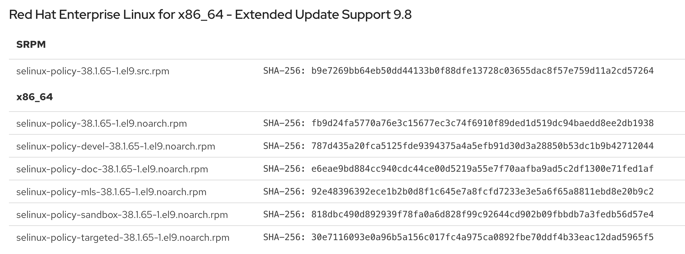

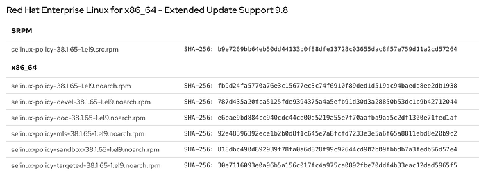

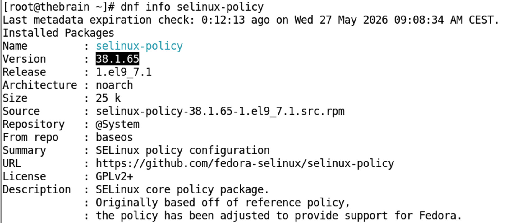

I run dnf upgrade with the flags --refresh --nobest and it works - but this is not nice :-). The version of seliunx for Rocky Linux 9.7 (current version) is 38.1.65. As I see even the current version of Red Hat (9.8) provides only 38.1.65 (see Other relevant data).

Information from Red Hat about selinux-policy versions (current version 9.8) from https://access.redhat.com/errata/RHBA-2025:20533
