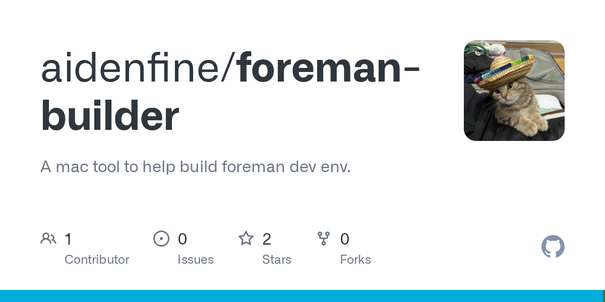

Built a tool to make Foreman/Katello dev environment work on mac
After struggling a lot to get Foreman/Katello dev environment on my mac. I went and built this tool called foreman-builder that will handle everything needed to get a container based dev environment working. I wanted things to feel as fast as possible and easy to get started.
It takes one command and about 20 minutes of waiting to install/build everything necessary to have a smooth dev experience.
I am looking for feedback or comments on how the tool works and if anyone else is using a mac how they current get the dev environment working.
