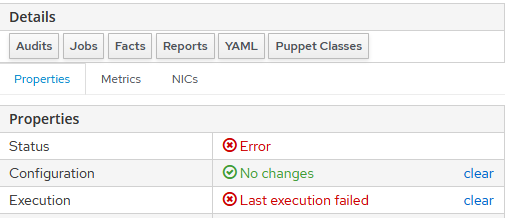

On our Foreman instance we have many hosts which status is set to “Error” because at some point there was a failed puppet run.
Let’s take one example:

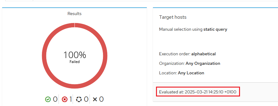

As we can see the last failed puppet execution occurred 3 months ago (current date is 2025-06-24) and since then all hourly puppet runs have been successful:

However, I don’t think this last suggestion would solve anything, as I mentioned earlier, on these hosts many puppet runs have run successfully since the failed execution.
Foreman 2.41
Execution status is not the one originating from Puppet, this would be Configuration. So I would also recommend simply running a job on all systems.
