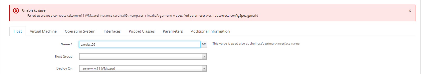

Recently I added our vcenter to foreman as compute resource. I tried to provision through the foreman
I got below error.
vcenter server versio. 6.5
esxi version 6.0
vcenter server has multiple data centers and clusters. multiple VLANs connected to each esxi host.
Foreman versiom 1.17.
Proxy versions: 1.17.1
please take a look on below log file. Please help me to fix this issue

2018-06-21T11:59:40 c75438d1 [app] [W] Failed to create a compute cdtsvmm11 (VMware) instance carultst09.rxcorp.com: InvalidArgument: A specified parameter was not correct: configSpec.guestId
| RbVmomi::Fault: InvalidArgument: A specified parameter was not correct: configSpec.guestId

2018-06-21T11:59:40 c75438d1 [app] [W] Rolling back due to a problem: [#<Orchestration::Task:0x00007f6f6f50f948 @name="Set up compute instance carultst09.rxcorp.com", @status="failed", @priority=2, @action=[#<Host::Managed id: nil, name: "carultst09.rxcorp.com", last_compile: nil, last_report: nil, updated_at: nil, created_at: nil, root_pass: "$5$vuBkKzQC$op5IOZSGC9YGZ3Wcck//gkEadBpd7yT6iJ7zrq...", architecture_id: 1, operatingsystem_id: 6, environment_id: 1, ptable_id: 119, medium_id: 12, build: true, comment: "", disk: "", installed_at: nil, model_id: nil, hostgroup_id: nil, owner_id: 6, owner_type: "User", enabled: true, puppet_ca_proxy_id: 1, managed: true, use_image: nil, image_file: nil, uuid: nil, compute_resource_id: 2, puppet_proxy_id: 1, certname: nil, image_id: nil, organization_id: nil, location_id: nil, type: "Host::Managed", otp: nil, realm_id: nil, compute_profile_id: nil, provision_method: "build", grub_pass: "$6$sgjxB6sP$kXBS5Bm7F34bforwNE3B2YP7KJmP3o2oX5sSlc...", global_status: 0, lookup_value_matcher: "fqdn=carultst09.rxcorp.com", pxe_loader: "PXELinux BIOS">, :setCompute], @timestamp=2018-06-21 15:59:40 UTC>]
2018-06-21T11:59:40 c75438d1 [app] [I] Processed 1 tasks from queue 'Host::Managed Main', completed 0/7
2018-06-21T11:59:40 c75438d1 [app] [E] Task 'Set up compute instance carultst09.rxcorp.com' *failed*
2018-06-21T11:59:40 c75438d1 [app] [E] Task 'Query instance details for carultst09.rxcorp.com' *canceled*
2018-06-21T11:59:40 c75438d1 [app] [E] Task 'Create DHCP Settings for carultst09.rxcorp.com' *canceled*
2018-06-21T11:59:40 c75438d1 [app] [E] Task 'Deploy TFTP PXEGrub2 config for carultst09.rxcorp.com' *canceled*
2018-06-21T11:59:40 c75438d1 [app] [E] Task 'Deploy TFTP PXELinux config for carultst09.rxcorp.com' *canceled*
2018-06-21T11:59:40 c75438d1 [app] [E] Task 'Deploy TFTP PXEGrub config for carultst09.rxcorp.com' *canceled*
2018-06-21T11:59:40 c75438d1 [app] [E] Task 'Fetch TFTP boot files for carultst09.rxcorp.com' *canceled*
2018-06-21T11:59:40 c75438d1 [app] [I] Failed to save: Failed to create a compute cdtsvmm11 (VMware) instance carultst09.rxcorp.com: InvalidArgument: A specified parameter was not correct: configSpec.guestId
