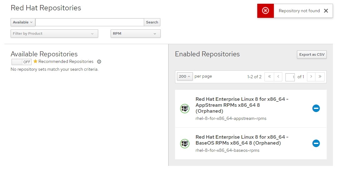

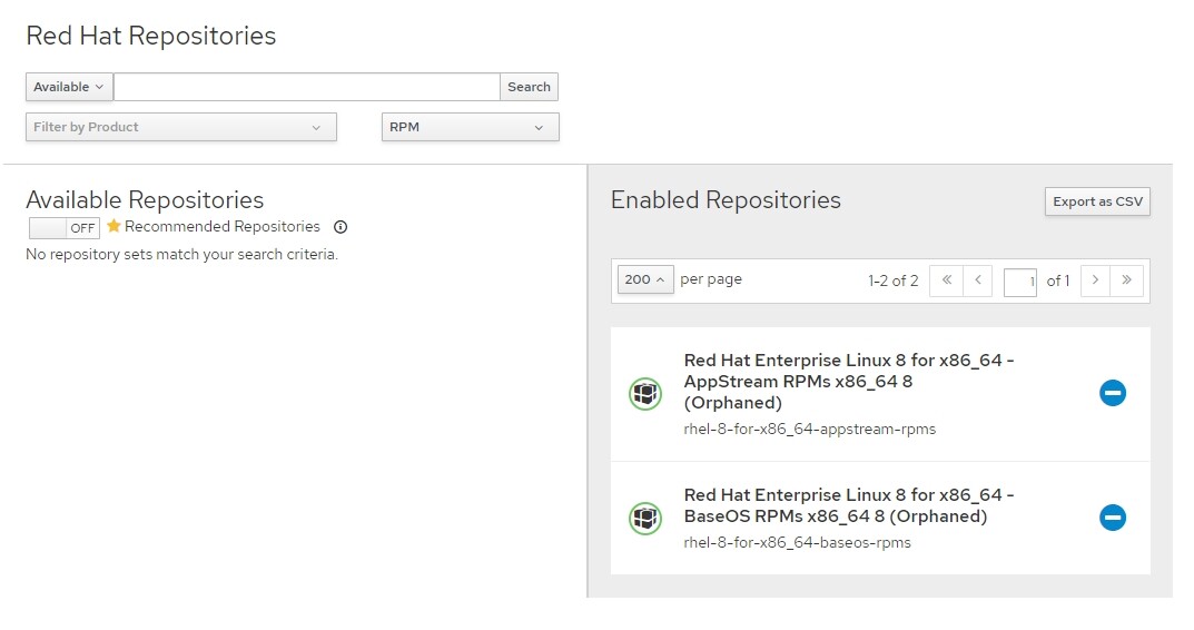

Katello 3.18. I needed to wipe out my redhat setup and start over. All good, except in the process my two repositories for redhat8 are now stuck in limbo. They show up as “orphaned”, and I cannot delete them.
Is there an override of some sort I can use to get rid of these? When I try to delete them I get an error that the repo is not found.
2021-08-06T16:27:03 [I|bac|] Task {label: Actions::Katello::RepositorySet::DisableRepository, id: a2c282a2-7e0c-47a7-a204-a1a3482255a9,                                   execution_plan_id: 43140f55-b91e-44fb-a98b-28ea0360f0e6} state changed: stopped  result: error
2021-08-06T16:27:03 [E|app|] Katello::Errors::NotFound: Repository not found

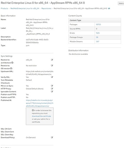

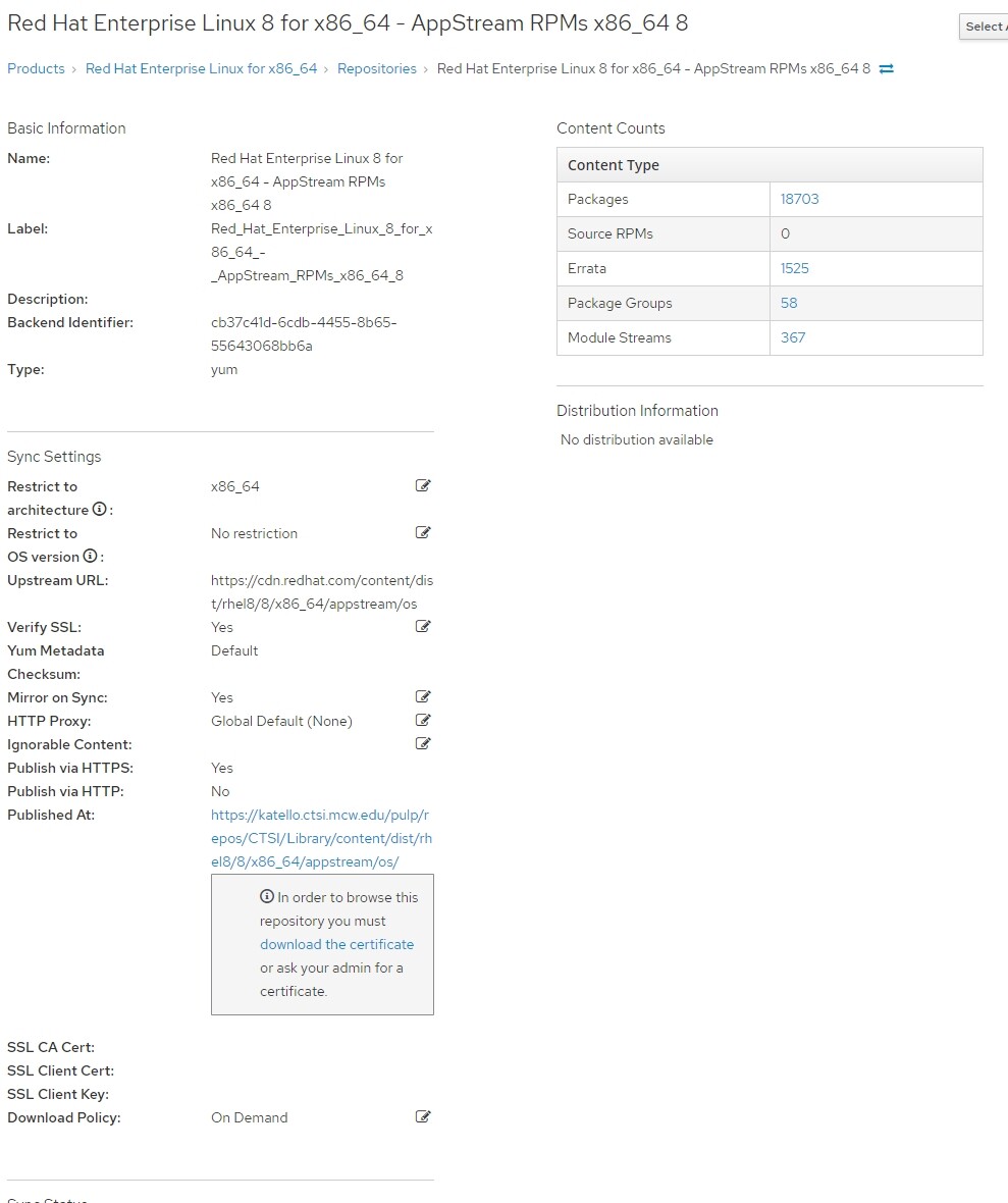

The repository seems to have been deleted already. Are you seeing any issues with the environment after the task failed?
Yes, since the entries are still there, I cannot delete the product(s), because the repo entries (2 of them) still exist as orphaned. I cannot delete them.
Does the Redhat Repository page still show those as enabled as well?
An attempted delete of either one gives this simple error only.
Oh…That’s helpful…Seems like the enabled repository set did not create a repository with all mapping fields or something left the data in a bad state.
Did you delete the manifest etc? Just curious as to how you reached this state and if we can reproduce and file an issue for this.
