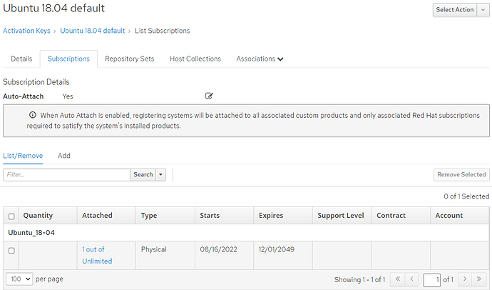

We are able to subscribe a ubuntu 18.04 host with the subscription manager and we can see:
subscription-manager list --match-installed --consumed --available
No available subscription pools to list
Consumed Subscriptions
Subscription Name: Ubuntu_18-04
Provides: Ubuntu_18-04
SKU:
Contract:
Account:
Serial:
Pool ID:
Provides Management: No
Active: True
Quantity Used: 1
Service Type:
Roles:
Service Level:
Usage:
Add-ons:
Status Details: Subscription is current
Subscription Type: Standard
Starts: 08/16/2022
Ends: 12/01/2049
Entitlement Type: Physical
That the required subscription is active and is correct. However there’s no repositories assigned and we cannot find the reason nor error why.

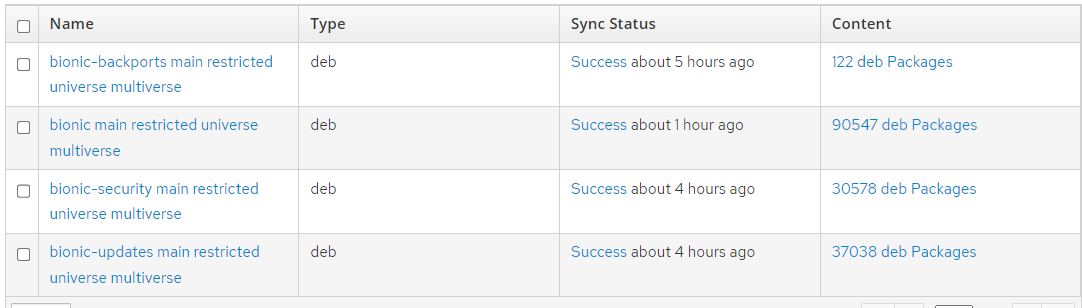

Here are the repo’s/products working well:

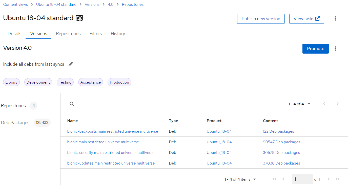

The content view which has the subscription:

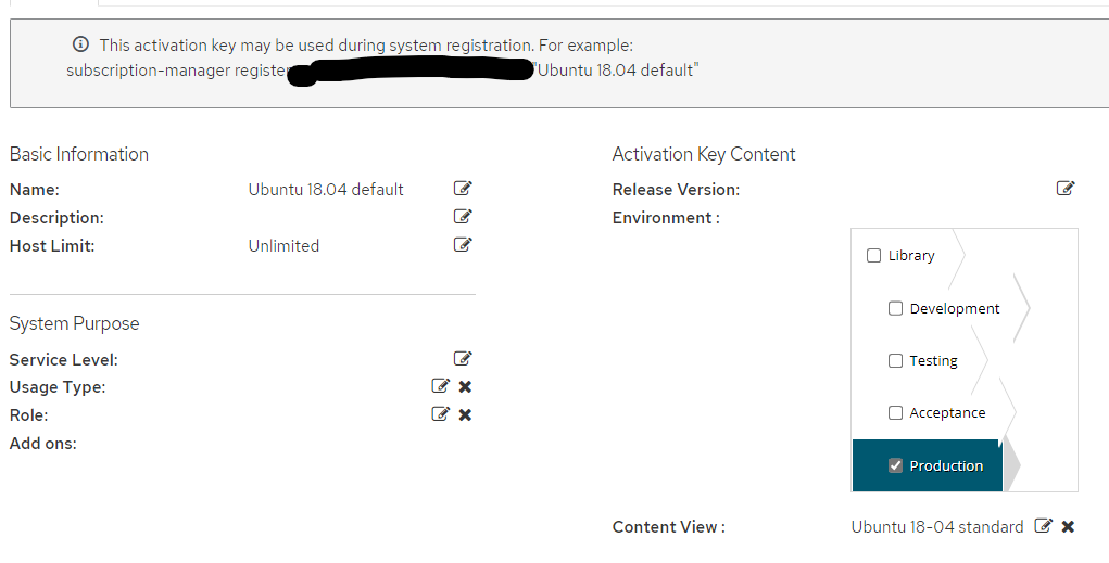

The activiation key:
We did promote it aswell and we see the host in the content hosts.

as you can see in the last image, your content view only contains 122 Deb packages. That would match the backports repository. But that also means, that the other repositories are not part of your content view and with that your host cannot see them. Probably you published the content view before the sync of the repostitories was finished or you forgot to put the other repos into the content view.
On the other side your host should get at least the backports repository.

I also promoted it again as i may have been a bit to early indeed with my publish + promotion.
I hoped i would atleast see the repo’s.
I tried to also re-subscribe but sadly still no improvements yet.

So i resetted the whole foreman-katello with the command and when i rebuild everything from the products op to the activation key (exactly the same). It worked on the host.
