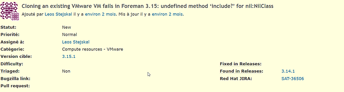

@lstejska do you have some free cycles to look at this one?
https://issues.redhat.com/browse/SAT-36506 added to our backlog

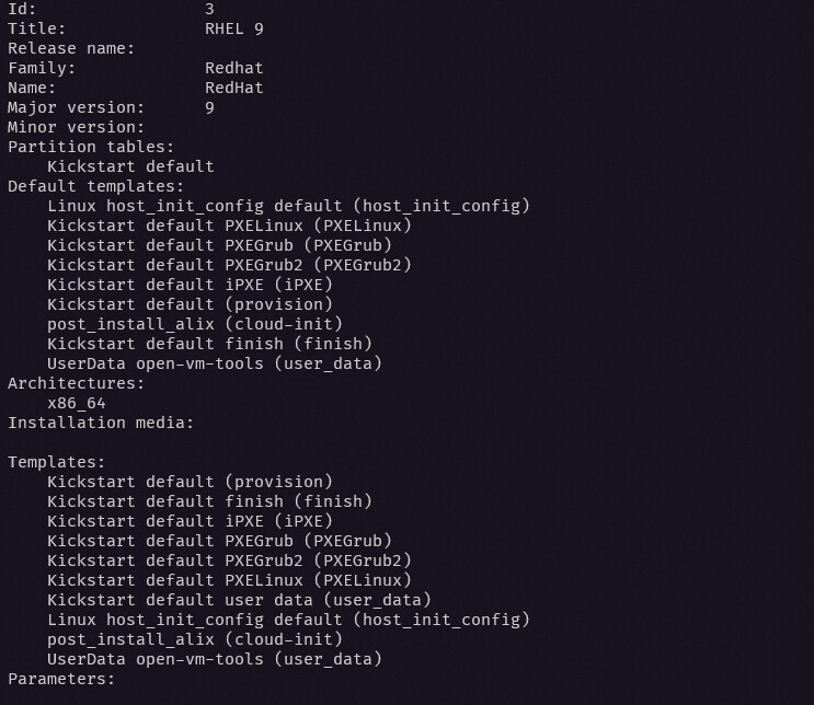

hammer os info

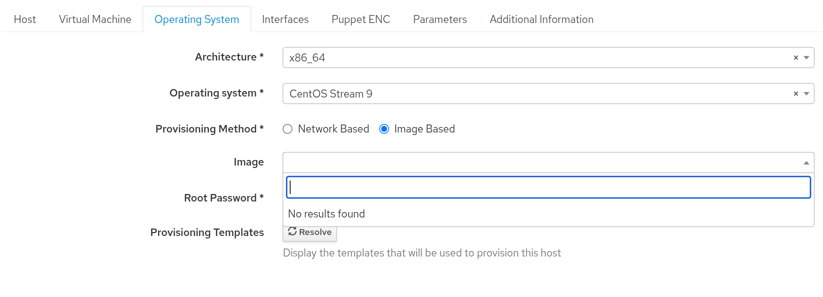

I’m trying to understand the relationship between templates, images, and provisioning methods when using Foreman with a VMware compute resource.
My current use case:
  • I need to clone an existing VM in vCenter (not a template) using Image-based provisioning.
  • I noticed that in the Host creation form there is no “Clone from VM” field in the VMware tab.
  • The only place where I can reference the source is under Compute Resource → Images, where I can create an “Image” pointing to either a template or a VM.

I’m talking about cloning a VM from the “clone” button, this opens a new page with the characteristics of the VM you want to clone, you just have to change the name + ip. When I say clone, it’s in the vmware sense, I don’t know if I’m clear.
Yes you are clear, but you also mentioned:
[quote=“orelops, post:10, topic:44043”]
[/quote]
To make sure, you should not point the (Foreman) image to the (VMware) virtual machine, but only to the template.
yes, absolutely.
I think I understand what the issue is, but let me first do some sanity checks that I understand your setup correctly.
  • You have a system in Foreman (let’s call it server.example.com), that is a VM on VMware and you want to clone it.
  • The clone should be (besides name/ip/mac address) identical to server.example.com, especially it should also have a copy of the disks server.example.com had at the time of cloning
  • The OS of server.example.com has no matching “image” known to Foreman
  • Images are Foremans representation of a VMware template with some additional data (like, which OS it belongs to, what the user is for the login, etc)
To check the image definition, you can list them with hammer:
# hammer compute-resource image list --compute-resource-id 1
ID | NAME | OPERATING SYSTEM | USERNAME | UUID | USER DATA
(The OS you show in your screenshot is called “RHEL 9”, so you’d want to look out for “RHEL 9” in the OS column here).

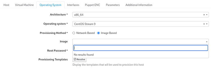

Now, when you go to the server.example.com host in Foreman and click on “Clone”, you get to a “Create host” form, that has most data pre-filled from server.example.com, and you need to enter a new name and expect a new copy of that host to be deployed. Instead, you get an error.
The problem (well, one problem) is that Foreman uses server.example.com as an input for the form data, but tries to deploy the new system from the image of the OS that server.example.com has, not with the disks of server.example.com has. But the OS has no image defined, and that’s where it explodes with undefined method include?.
You should be able to reproduce this also by deploying a fully fresh system with the same OS, as the “image” field remains empty:
