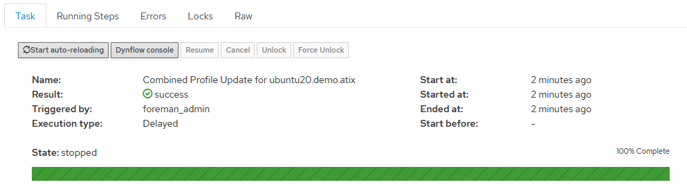

That means that it uploaded the new package list and should trigger a new task like that:
And that task recalculates the updates for that system.
That would be the usual workflow but maybe the upload fails for some reason or the task is not triggered.
