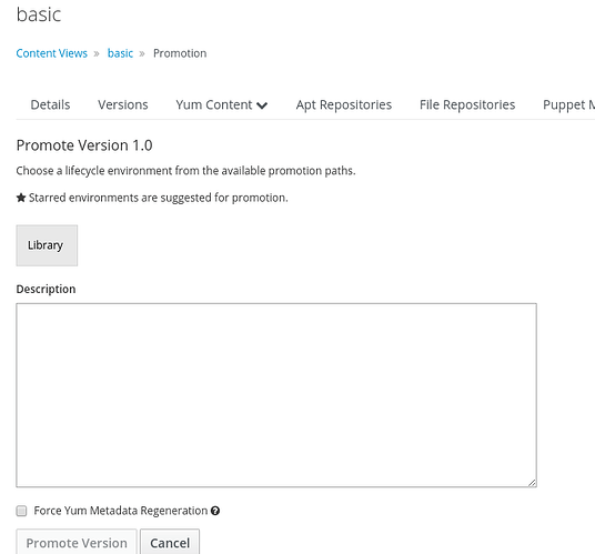

Thanks, that is insightful for sure. I noticed I cannot ‘promote’ a version of my content view, but it is the only version I have created. Would that be because it IS the only version?
Thanks.

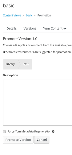

If you cannot promote a version, that usually means there is no environment to promote to. Having only Library environment when I create a content view and publish first version (1.0), I cannot promote it, because the version is already in Library:

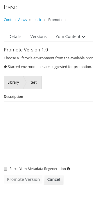

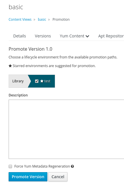

When I add ‘test’ environment, I can promote it there:

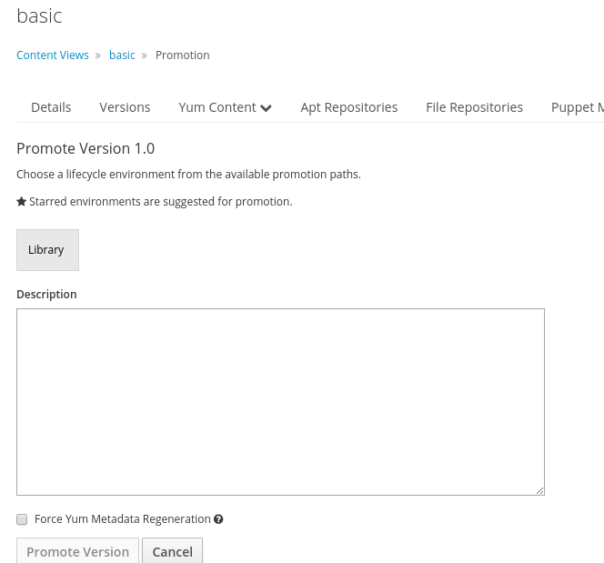

After that, I am out of environments where to promote again:

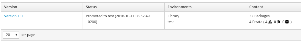

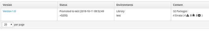

Because the version is in both Library and test now:

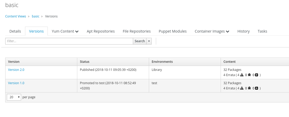

But I can publish a new version which will appear in Library and start promoting again:
