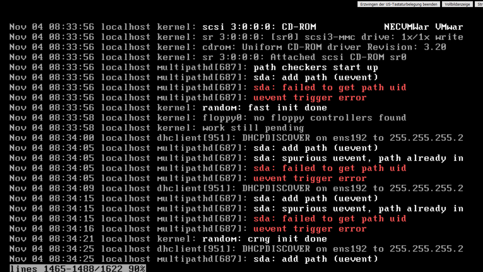

On deploying a VM using Foreman + Discovery on an ESXi-VM I am getting sda failed to get path uid

When/where do you see this? On the discovered node? Anaconda installer? After installation?
Are you sure about this version? That should be 16.0 for this Foreman release.
I get this error after I provisioned the host from the foreman’s discovered hosts page. This kills the installation process and the installer exits into dracut.
The “waiting for kexec into installer” disappears and right after this I am getting the result you see in my screenshot.
Ah, sorry. I took the version from the smart-proxie’s details page.
This is the correct version: 16.0.1
KExec does not work reliably on VMWare as well as other environments. If you can’t afford PXE, then use Bootdisk with VMWare integration.
