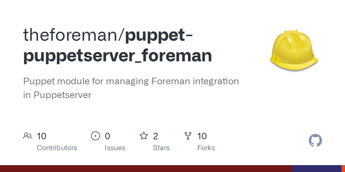

Correct. We only publish the integration bits here:
That relies on the client certificates on the Smart Proxy (by default), so integrating that is tedious.
The architecture is roughly:
Foreman <-> Smart Proxy -> Puppetserver
        <-             <-  Puppetserver
The Foreman uses its configured client certificates to connect to the Smart Proxy. Then Smart Proxy uses its configured client certificates to connect to Puppetserver. Puppetserver (via the puppet-puppetserver_foreman scripts) connects back to Foreman, but using the identify of the Smart Proxy.
We’ve talked about the Puppetserver talking to Smart Proxy, but never finished that. GitHub - theforeman/smart_proxy_reports was a partial solution (still left out the ENC and fact uploads), but has since been abandoned due to a lack of time.
You could opt for a classical Smart Proxy installation in the short term and first focus on getting the Foreman part containerized.
