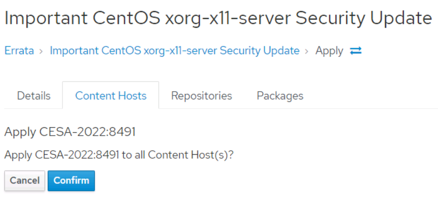

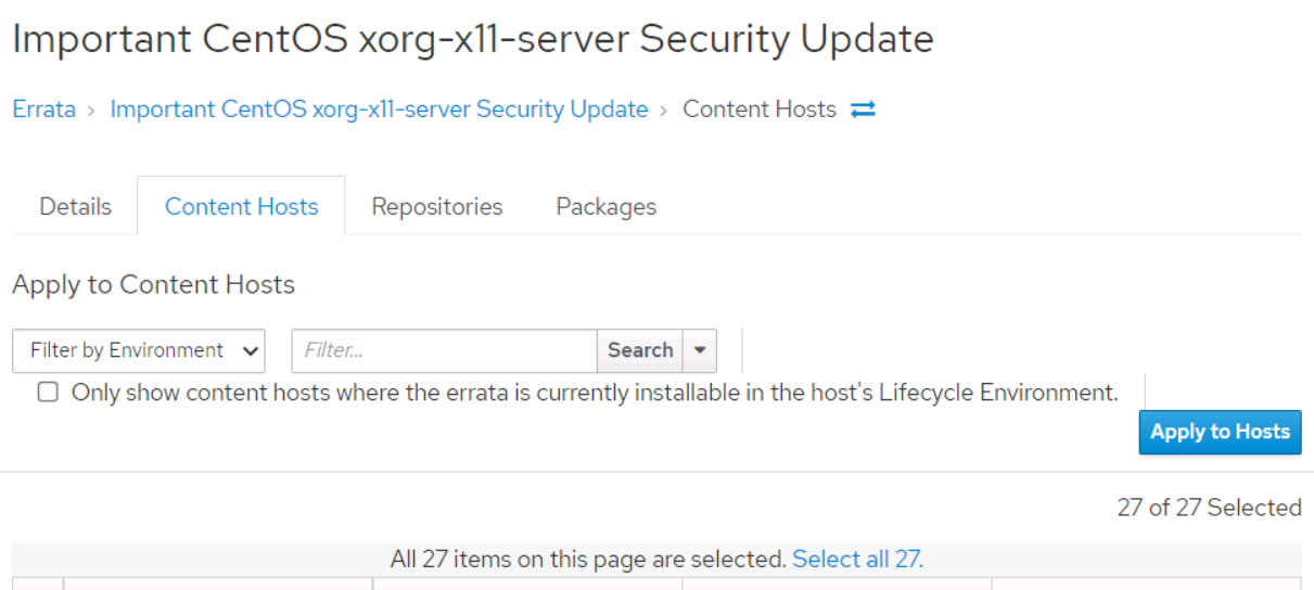

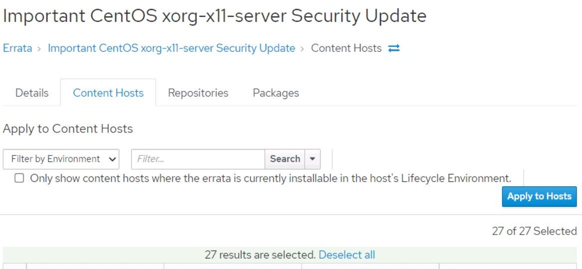

On Foreman 3.5.1/Katello 4.7 and when selecting an errata that is applicable to more then 20 hosts, I select the first 20 hosts on the “Apply to Content Hosts” tab and then select all and then “Apply to Hosts”, no hosts are selected.

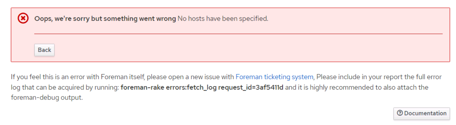

When I select Confirm on this page I get:

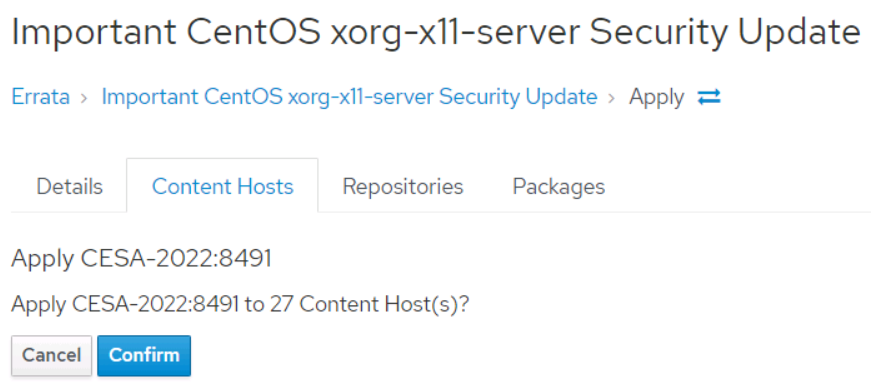

Workaround is to change the number of hosts shown per page to 100, select all hosts. This time all hosts are selected properly to be able to apply the errata to the 27 hosts.

# foreman-rake errors:fetch_log request_id=3af5411d
WARNING: Sidekiq::Web.sessions= is no longer relevant and will be removed in Sidekiq 7.0. /usr/share/gems/gems/sidekiq-6.3.1/lib/sidekiq/web.rb:75:in `set'
2023-01-09T12:24:53 [I|app|3af5411d] Started POST "/katello/remote_execution" for 10.107.17.18 at 2023-01-09 12:24:53 +0000
2023-01-09T12:24:53 [I|app|3af5411d] Processing by Katello::RemoteExecutionController#create as HTML
2023-01-09T12:24:53 [I|app|3af5411d]   Parameters: {"remote_action"=>"errata_install", "name"=>"CESA-2022:8491", "bulk_host_ids"=>"{\"included\":{\"ids\":[]}}", "customize"=>"false", "authenticity_token"=>"Ab0IiHLoc7xl87j3g4BbJ49aNI4vgSBgsg8e5VMAdhFmgfJJeIwFkwrdFYbjJ6k4BvS/tdkkGZ0yf5R2mvgsRg==", "install_all"=>""}
2023-01-09T12:24:53 [W|app|3af5411d] No hosts have been specified.

2023-01-09T12:24:53 [I|app|3af5411d] Completed 500 Internal Server Error in 33ms (Views: 24.7ms | ActiveRecord: 1.1ms | Allocations: 28611)
Foreman version: 3.5.1
Plugins:
 - foreman-tasks 7.1.0
 - foreman_ansible 10.1.0
 - foreman_openscap 5.2.2
 - foreman_remote_execution 8.1.2
 - katello 4.7.0
