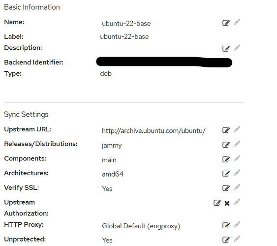

I previously had this working, but needed to rebuild the size of my disk because security repo was set to main restricted universe and multiverse.
I have tried cleaning up the database, deleting and reconfiguring the repo, but always get this same error now. I have looked at some of the other topics that are kind of similar, but don’t seem to apply directly to what I’m trying to do.

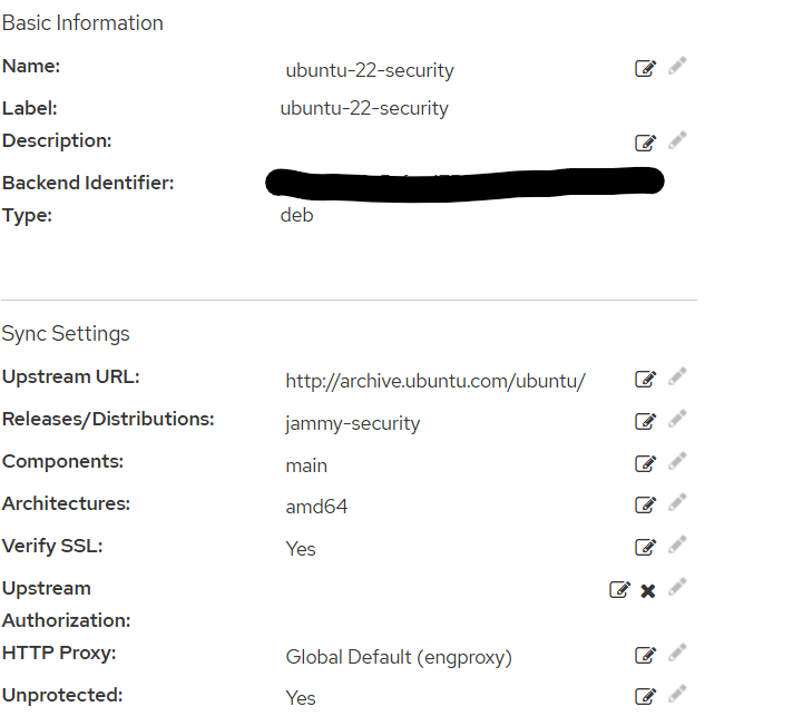

FWIW, I decided to try security repo again, and that seems to have worked:
But, I don’t understand why the other fails with:
Error: No declared artifact with relative path “dists/jammy/main/binary-amd64/Packages” for content “<PackageIndex (pulp_type=deb.package_index): pk=019c6d08-0eac-7872-b656-79fab1bb6b58>”
They appear to be identical with the exception of release/distribution
