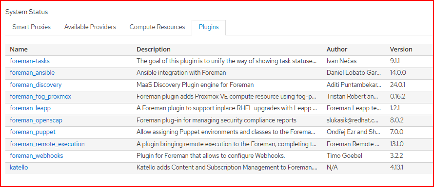

Foreman and Proxy versions: F 3.11.4 K 4.13.1
Distribution and version: Rocky Linux release 8.10
